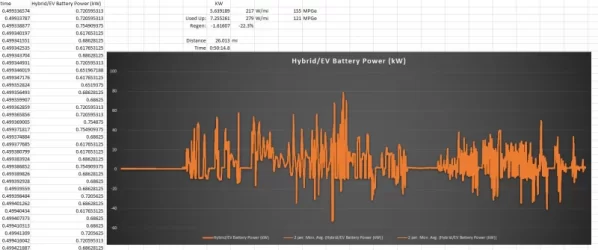

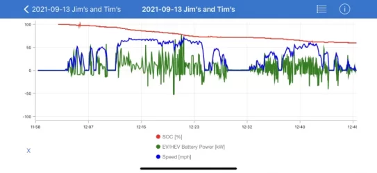

I was recording ODB parameters for a 26-mile trip I made today and I was wondering how much regen I got. For some reason, it bothered me not to know how much difference regen makes. So the Car Scanner app has a data recording functionality that allows for the user to record all the parameters and then export them to Excel. Today I drove 26 miles and here are some interesting numbers:
The trip was a mix of freeway and city driving and some waiting in the car (freeway speeds of around 65mph).
The trip took 50 minutes and 14 seconds and covered 26.013 mi
State of Charge at the start was 100% and 60% at the end.
The car used 5.639189 KWh of battery capacity.
It actually used 7.255261 KWh but it was able to regenerate 1.61607 KWh which resulted in the 5.63...KWh final number. That is ~22.3% regen which is higher than I expected.
My trip MPGe was 155 when you include regen and 121 MPGe without it.
The process to get these numbers.
1.) Recorded Data in Car Scanner app
2.) Exported it to CSV
3.) Created a graph and calculated the area under the curve (5.639189 KWh)
4.) Calculated the area under the curve for positive numbers (7.255261 KWh)
5.) Calculated the area under the curve for negative numbers (1.61607 KWh)
Here are some pictures.
Here is the State of Charge vs. Battery Power vs. Car Speed in Car Scanner:
Here is the same in Excel:
Anyways, not sure if this is interesting to anyone but I think 25% regen is realistic and makes a lot of difference.

Well depends on what are you trying to answer. In the case of regen, the best thing is to run it in the EV mode and then look at the negative area under the curve as regen (since nothing else should be generating negative power). In the case of HV if you are wondering how much power is generated by the engine there is another parameter that is called "Instant engine power (based on fuel consumption)".That parameter is also in kW and I was able to see that when the engine is running at 1,500 RPM it is generating ~4kW of power and the HV/Battery power was showing -2kW at the same time. This means that the car was using 2kW and the other 2 kW produced by the engine was used to recharge the battery.
The Car Scanner has the ability for you to create different dashboards and one of my dashboards has both the power by battery and power by the engine.
OK, so I have an update on the regen numbers. This time I recorder two trips in town. I drove somewhere and back (6.6mi each direction) and I have recorded the trip there and back. I got 40% regen in both directions. The numbers were so good that I started questioning my methodology but when I checked the area under curve against SOC number (SOC depletion * ~14kWh) everything matched.
Anyways either my methodology is incorrect or in town regen is 40%! You decide.
