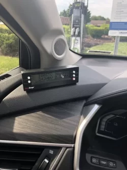

See picture below. I usually stop at 340v (340/84=4.047v) on a full charge but on that day it went up to 342. I attributed this to one or all of three reasons. Ambient temp was 96, I might be out of balance as I only fully charge twice a week and/or I took the reading right after charging was completed.
Never the less the Emergency Response Guide says max voltage is 352. Open circuit voltage is not linear as it relates to SOC but it is most accurate near the top and bottom of charge state. For that reason I believe we are in the 96% range.
The Voltage is correct, but that isn't 96% SoC. Again, it is more like 85% as battery SoC is not linear with voltage so you can't just take 4.05/4.2 volts. Look at the charge curves on pages 4 and 5 of this study: http://www.mdpi.com/2313-0105/4/1/11/pdf
And draw a line from 4.05 volts and you will see it is about 80 to 85% SoC for those two NMC cells.
Yes, it is sort of linear in that region, but again, not accurate to take 4.05/4.2. If you did a linear model you would have to say 3 or some other non-zero value as the bottom, so you would take (4.05-3)/(4.2-3) which would be 87.5%, but this still doesn't really fit. It is not safe to assume a linear relationship for Li-ion, which is why people model this behavior to get more accurate SoC based on Voltage.
Here is another chart from battery university that shows 4.05 V corresponds to about 80-85% SoC.
