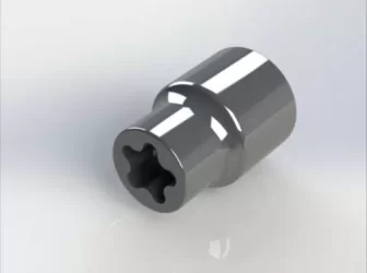

It's looking like the Pyro Fuse is the culprit. Any chance anyone in Southern LA has a 5 Point Socket I could rent for removing the penthouse lid? :)
