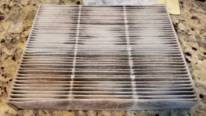

Did you replace it with Hyundai OEM or another manufacture, please include part#.Did my 15k mile service.. Only required item to be changed was the cabin air filter.. Takes less than 1 minute to change.. Had to order the filter as my local Hyundai dealer did not have it in stock.. Below a pic of my old filter..
Probably $35 to $50.. I take mine out every 6 months and blast mine with my air compressorDid you replace it with Hyundai OEM or another manufacture, please include part#.

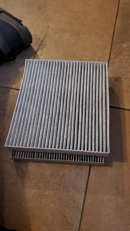

I used OEM. Had to order online 97133-K4000Did you replace it with Hyundai OEM or another manufacture, please include part#.
That's the one for the ICE Kona.. It won't fit.. I made the mistake and got one for the ICE Kona first but it did not fit..Here's a typical deal on a filter, and of course they're easy to install.

Can you provide instructions on how to change it?Did my 15k mile service.. Only required item to be changed was the cabin air filter.. Takes less than 1 minute to change.. Had to order the filter as my local Hyundai dealer did not have it in stock.. Below a pic of my old filter..
I'm in the process of sending that very filter back to Amazon. Although it *says* it fits Kona Electric, it doesn't (too small)I found this non-OEM one on Amazon for $26.50 plus free shipping for Prime members:

Good to know. Thanks.I'm in the process of sending that very filter back to Amazon. Although it *says* it fits Kona Electric, it doesn't (too small)
R0000 will not fit.. That's the one I first got and it's too big.. the cover will not close with that filter. It has to be K4000I found this non-OEM one on Amazon for $26.50 plus free shipping for Prime members:
https://www.amazon.com/dp/B07YSF2MJT/ref=cm_sw_em_r_mt_dp_U_qrp8DbP0BRBAX
R0000 is 1.5 cm narrower but 1 cm deeper (lid will not close).
So, if it fits ICE Kona, it won't fit the Electric Kona.. They are not the same.
