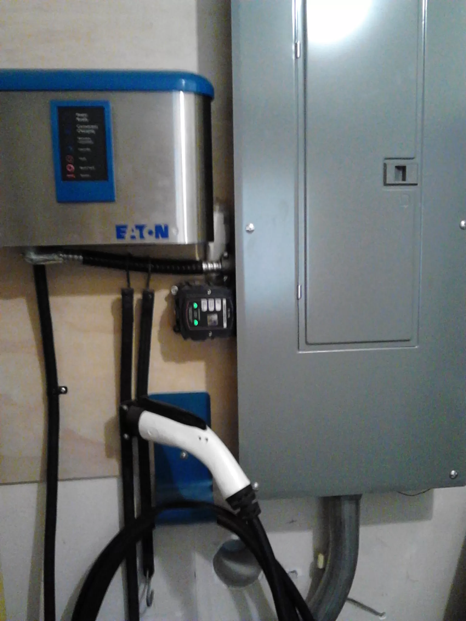

Picture of my setup:
One thing I didn't mention is a good idea to have whole home power surge protection (pictured below my EVSE side of panel). In this area the power does surge/brownout at periodically and is an effective way to provide protection for all electronics (including the car if charging during an occurrence). Install it as close to the main breaker as the panel bus will allow.
When I use the EVSE, I simply run the cord out of my old meter base location which I made an insulated hinged door covering a 4" hole (seen here and also first picture below the panel) to the right above a 20A outlet which I also installed (just in case);)
Yes, that's a pretty nice setup. Easy for you, being an electrician, but would cost me a lot, am sure.
