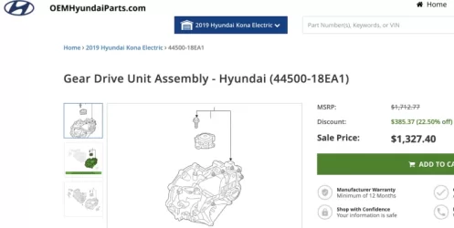

these were the replacement parts:
44500-18EA1 Gear Drive Unit Assembly (aka Trans Gear Drive)

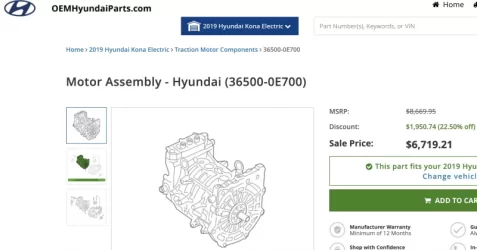

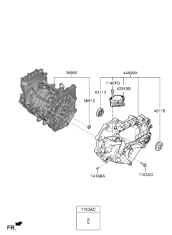

This clarifies things a bit (for me). The motor unit is separate from the gear unit. I still wonder which one my dealer intends to replace? The gear unit is the light coloured one. Motor unit is darker
I had to search your posts to find out what your dealer said:
... They are going to replace everything. Motor, reduction gear, everything...
So that's the two big lumps in the image. Good thing because replacing just one is not likely to be a permanent fix.

That's my worry. They SAID they were replacing everything but I really don't know if that's actually what they're doing or if the order form for parts had all the correct boxes ticked! And I've seen so many stories from people having one or the other replaced, some with good results but others right back in the soup having to get something else replaced later.
