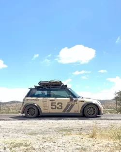

The ebike is 117lbs with the battery removed. Hitch is 200lb tongue weight rating. Rack is 150lb max but only rated for 50 lbs per bike… to be seen how it fares loaded up like this. Can’t find any rack rated for 117 lbs that fits a 1-1/4” receiver.

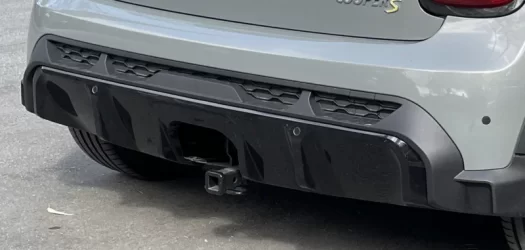

Curt C11417 is the one I bought. To your earlier question, yes the whole rear bumper has to be removed for the installation.
