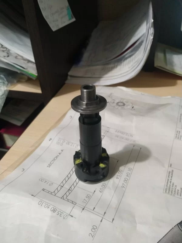

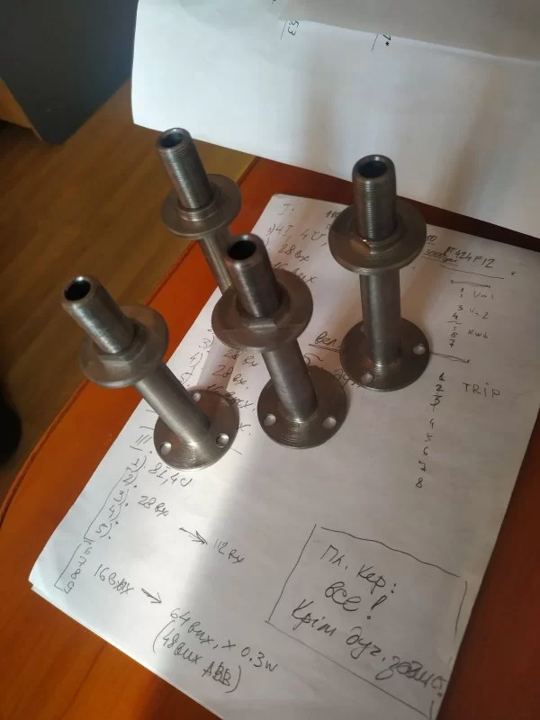

Hello all.
I can share my experience in Clarity mirror fixing. The result is a full functionality of a mirror. Since we are in Ukraine, only way to own a Clarity is to purchase a broken car on auction in USA, so sometimes cars arrival with broken mirrors .
All you need to repare the mirror is to produce (or order) two detales: axis and nut, according to drowing. Then the crashed parts of original axis insert on new axis with a silicon auto glue, after curing replace old axis with this assembly .
Best regards, Victor.
View attachment 14902 View attachment 14904 View attachment 14905

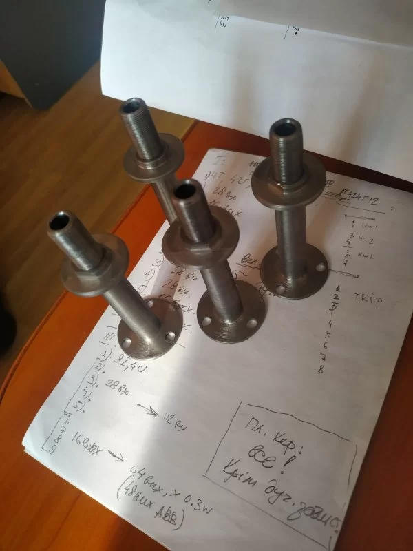

Hello all.

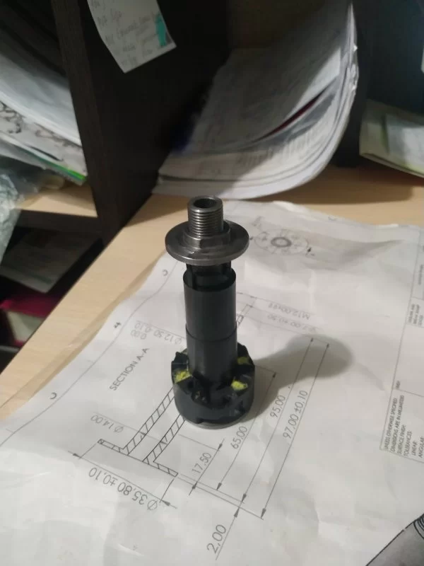

Hello all.
I have just finished repairing a broken passenger side mirror on my 2020 Clarity. It was broken at the pivot by a collision with an empty trash can being wheeled past the car! My total cost was $1.50. The repair was done by reinforcing the plastic pivot tube internally with a steel tube, similar to the repair discussed in this thread by Victor PP on Jan. 17, 2022. Victor PP used custom machined steel parts. I did my repair using off-the-shelf threaded rod and nut from a lamp parts store. ¼ ips threaded rod is ½” OD and fits loosely inside the pivot tube. It has enough ID to fish the wire bundle through easily. Epoxy can bond the metal tube inside the plastic. The type of epoxy is not important because the nut at the base of the tube will take the force exerted by the spring.
Although I used parts salvaged from an old inexpensive torchiere style floor lamp, I think the similar solution given here would work better. A 1” dia. 1/16” thick ¼ ipt brass nut secures the tube at the base of the pivot assembly (may need to cut some relief for the screws that mount the assembly to the plastic base that bolts to the car door). About 4” of threaded tubing should be enough, you can cut to length. Any ¼ ipt hex nut is used at the top of the threaded ¼ ipt tube to compress the spring, as in Victor PP’s design. The total cost for the lamp parts should be only a few dollars plus shipping.

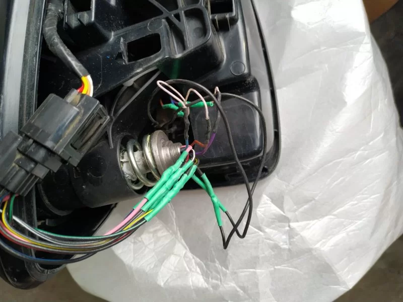

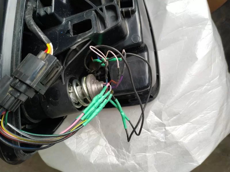

A rogue wild turkey took off my passenger side mirror over the weekend. After reading many threads and assesses the costs I found a way to very securely screw it back on. Here are some photos of the approach.
I started by drilling two pilot holes through both the mirror base and mounting bracket. I put nylon washers under the 1.5” sheet metal screws to dampen any shock. Also required some minor soldering to reconnect the mirror servo. Almost as good as new, just no longer folds in. Better than glue or a 1k dealer install. -Z
Similar thing happened to me but the force was under the mirror and up; snapped the axis post. Looks like your key step is to remove the mirror cover. How did you do that? Seems tricky; I'd probably break it and the mirror. Advice?
