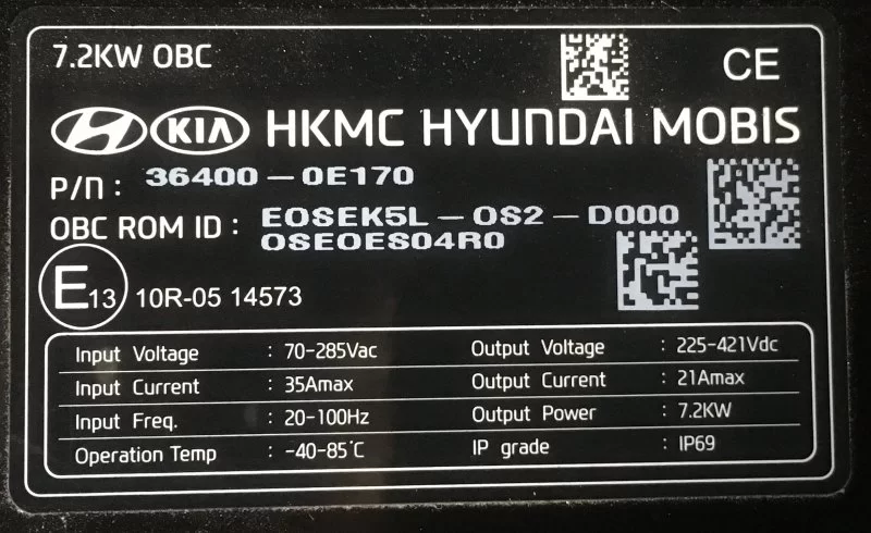

As for the OBC DC charge rate, despite the nameplate 7.2 kW DC, noting the wide range of AC inputs possible your result is dependant on your line voltage and the EVSE being set up for 30 or higher amps. 7.1 to 7.6 kW have been reported as a dash reading and anything in that range is considered the full rate.
The 7663W rate I measured input of the EVSE with an rms clamp on and fluke voltmeter (about 15 M from the supply transformer) . Although rated for a higher input voltage, I don't think charging at a higher voltage (over 245V or possibly 277) would do the OBC much good as it's current limiting might get overheated.
What engineer is going to sign off a product that can’t operate reliably at every corner of its nameplate rating?

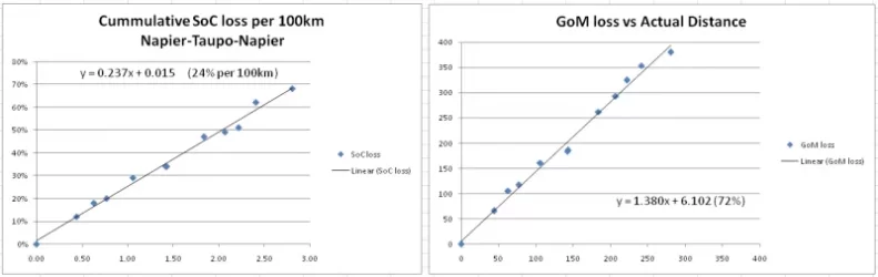

The only readings I really trust are the odometer and the SoC. The latter still needs to be tested for having the linearity we expect with energy used, or, since we don't know that, the proxy of distance driven will have to suffice. The graph (which I've posted before) is a 300 km round trip over several hours to test this. It's a mostly-hilly drive with an average speed of less than 80 km/h.
The first graph is distance driven (in 100 km blocks) graphed against loss of SoC (because that's what happens.) The first data point at the lower-left is at home and the data point at the upper-right is also at home, without any charging stops. The slight "S"-shape in the data points is due to the hills and higher altitude of the destination, which is at the midpoint. The reason for collecting data at numerous waypoints is to validate the linearity of the SoC, which it has, down to 32% SoC. The slope of the curve (24% SoC per 100 km) is the summary of the round trip. The dithering either side of a straight line is remarkably minor considering the variations in speed and hills up to 760 m.
The second graph is loss of GoM v.s. distance driven, both in kms, characterising the GoM for that day only. The summary of the trip is that the GoM returns 72% of what it estimated, pretty far off but it wouldn't have had a chance to estimate my range because I didn't do the same drive every day the week before. Again, the dithering is very slight considering the same variations in driving.
