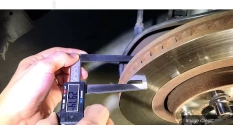

I'm not sure what you are measuring, but a rotor thickness of 0.12" is inconceivable.
This is how a rotor is measured, and it would be impossible to get down to 0.12" and have anything left at all !

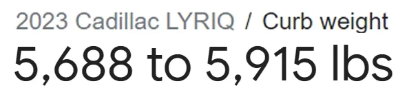

The aluminum rotors will help compensate for the weight of the 500-mile battery.
Still a ton and a half lighter than a Hummer EV.
