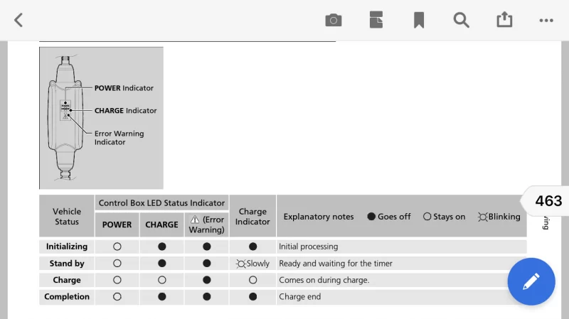

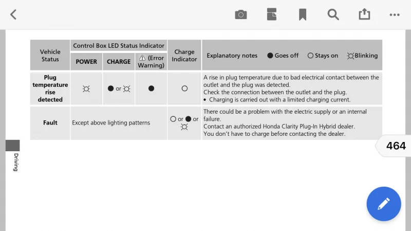

See p 461 and 462 in the manual for details of what the different combinations of indicators signify.
Both Power and Charge blinking on the brick signify a rise in plug temperature due to a bad electrical contact at the outlet. The Clarity usually charges at a much lower level when this happens and the green charge light at the car charging port will stay green showing you’re getting some level of charge.

I suggest you check the connection(s) at the outlet and extension cord (if used) and make sure they are tight and in good order. And for the next few charges, check and see if they are getting hot.
If that’s not the case and it’s just a one time affair, it may have been a power fluctuation from the grid and/or your house. In any event check those connections and make sure to get the 18-097 update.

Here’s a screen shots of the pages
Thanks for the info, all. When I got home tonight I charged for about an hour and checked the box and the plug. They were both a little warm. I changed outlets and will check again in an hour. Is a little warm ok? I think I might just be paranoid now.
I suppose we all have different interpretations of "a little warm" but it sounds OK to me.
Just to update, I used the other outlet and the plug is cool to the touch. The other outlet was not alarmingly warm, but I’m surprised at the difference. I’ll be using the new one now heh.
