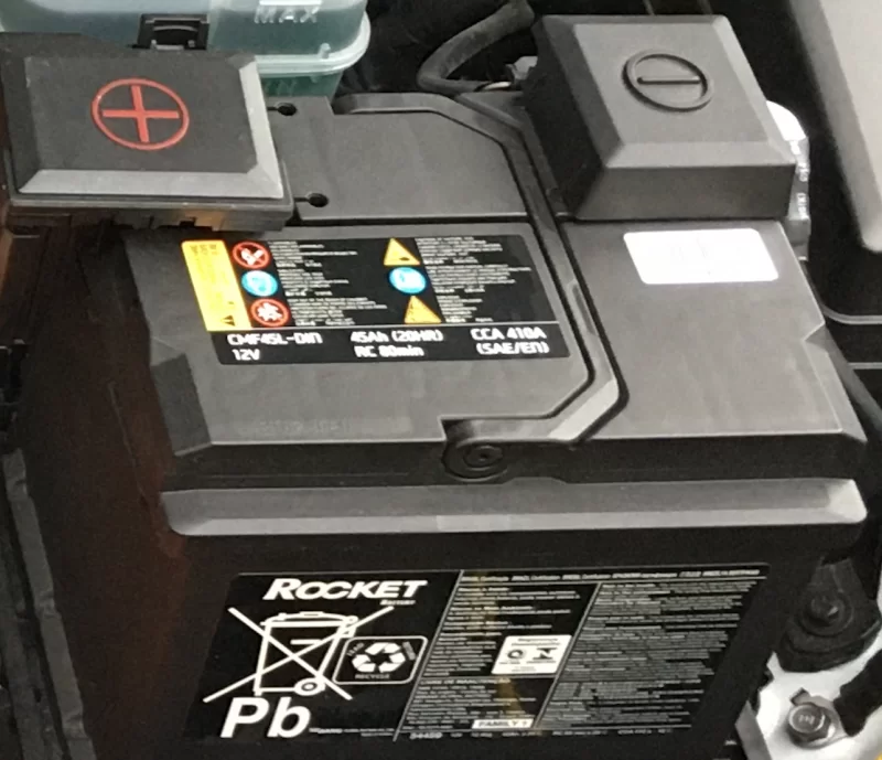

The Kona appears to have a battery suited to a small ICE car with 410 "cold cranking amps" ability and 45 Ah capacity.
I see no reason why you can't use it to start a small ICE if you disconnect one of the terminals to ensure the Kona is not involved, but it's a risk otherwise.
The battery might handle it (terminal disconnected) but then you have issues like resetting software configurations, windows and sunroof (if equipped).
Probably less hassle just to use a conventional battery charger on the ice, and avoid any problems with the Kona's 12 V recharging system after the depletion.
