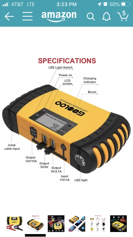

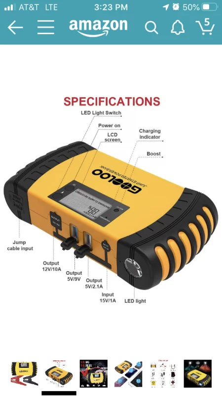

View attachment 7283 Fact: The manual is silent on whether boosting another car’s battery is allowed or prohibited.
Opinion: Common sense says it should be like any other car if you have the Clarity on so the HV battery will supply charge to the 12 V battery as needed. However, since there are so many expensive electronics involved and to be in the safe side I agree with @Mowcowbell @Landshark and @craze1cars . I carry a Gooloo (funny name, great product and not your usual cheap Chicom knockoff) Li-ion booster in the cubby under the trunk floor.
About $75 for the larger size on Amazon or EBay and has a 4.5 star rating from over 1,500 people. It also comes with a very nice hard shell case and will charge your phone many times over if stranded in the snow. Also has a light. I thought it was good insurance and no more tangled cables.
And @craze1cars is spot on about old and cheap cables. If you’re going to carry jumper cables spend extra to get the copper wire kind, not the cheap a** copper plated aluminum junkers that are now sold every where and are not as good as the old all copper ones we grew up with despite their wire gauge. Expect to pay about $50 to 60. Buy once, cry once, and it will always deliver the Amps.
GOOLOO 1500A Peak 20800mAh SuperSafe Car Jump Starter with USB Quick Charge 3.0 (Up to 8.0L Gas, 6.0L Diesel Engine) 12V Auto Battery Booster Portable Charger Power Pack Built-in Smart Protection
I have had one of these for some time (longer than my Clarity), it is excellent and very handy if you don't have another car around when you need it. You just need to check the charge and plug it in to replenish after using it.
