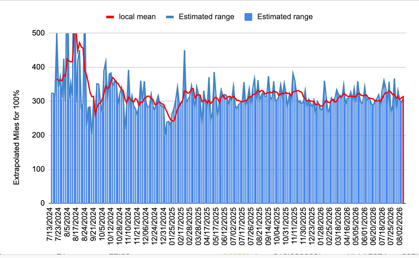

I have been monitoring the estimated 100% range over 2 years...it fluctuate by season and speed of driving etc...but in the chart below i estimate the range at 100% at every charge...the way high numbers is when i do low speed drives....most of my driving is at 75 mph...
You can see the average is still pretty flat...degradation should show a downward trend in the red line...one can see cold weather affects range most.

Oh there are people who drives at 40 to 50 mph always ...and their max range at 100% will be near 400 miles. The onboard computer adjust the range on the Guess-o-meter by adjusting over the last few times you drove and charged,,,,that 326 miles you are seeing is a combination of your recent miles/kWh and counting how much energy you put in. When it is very cold weather I see mine go to less than 270 miles at 100% and in spring and fall it will go to 340 miles.
All I am saying is the guess-o-meter range is not the state of health of your battery.
I believe some OBDII readers may give you what the BCM believes is the State of Health of your battery...i.e how much of the original capacity it is.
Anyways from my estimate over 2 years of data collection and +27000 miles...I estimate my car's battery degradation is at worst 2%
