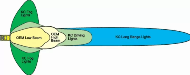

What @SameGuy said. Fog lights are intended to illuminate the sides of the road so you can see where the edge of the road is. What you are describing are more like driving lights
Fog lights are meant to illuminate the sides of the road for when you can’t see too far past the front bumper.
I respectfully beg to differ. Fog lights are meant as a remedy for headlights when the headlights are aimed far down the road and reflect too much light from the fog. Fog lights are to be mounted low, and cut underneath the headlight beams. They also have a wider spread than headlights. Fog lights should also be amber (even less reflection). Driving lights, on the other hand, are intended for jacked up pickup trucks (frequently driven by yahoos) to blind other drivers. See the distinct difference?

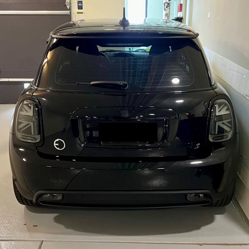

Check out my link here for what I used for side markers and rear fogs. I bought smoked tail lights like @endquote as there's no way I could get them to look that good on such a big surface area...
https://www.minif56.com/threads/side-marker-lights-for-2022.91984/post-870539
I've got replacement smoked rear fogs to go in and have the aftermarket tail lights coming. Wanting to smoke or get replacement smoked sidemarkers (but it looks like replacements aren't available for 2022+). I may see about removing the stock side markers to wrap them. Any reason you didn't do that and choose to tint them on the vehicle?
No no, that is a vinyl material I used. It isn't like window tint.
I didn't remove the side markers because they're just stuck in place using an adhesive. So I didn't want to mess with finding the right adhesive to put them back on, and potentially breaking them when removing them. Honestly applying the vinyl with them on the car was super easy and I feel like removing them might actually make it harder to do...
Also, I wrapped on the rear fogs since I had plenty of material. Figured why not. If it turned out bad I knew I could just buy the actual smoked ones. So far seems to be holding up great!
