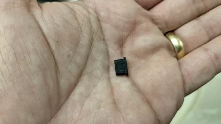

The other day, before plugging my phone in to the car USB, I pulled out the tiny silicone USB-C plug that I use to cover the phone port. Set the tiny piece on the elevated area next to the gear-shift (which I'll never do again). Drove. Arrived at destination. Looked for the plug -- couldn't find the plug. Strange, must have fallen on the floor or under the seat.
When we came back to the car, immediately got an error message with something about putting the emergency brake on while the car is in Park. Like @DucRider, I noted the gear indicator was also blinking. The car drove fine, but the message was still unnerving.
We stopped a bit later, and fortunately I had the ODB-II scanner so gave it a shot. What did I see? Error code P26C3.
I took a deep breath, searched for the code and a bit of the error message, and found @DucRider's post and the moment I saw the word "debris" I stuck my finger in the Reverse slot and OF COURSE the USB-C plug had fallen in. *facepalm* Fished it out, restarted the car, and error message was gone.

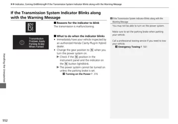

YIKES! I think the page below (p. 552) documents the error message I saw. Pretty brazen of me to just drive off when I saw it, but (a) the car otherwise behaved normally, and (b) it didn't SPECIFICALLY say "YOUR TRANSMISSION IS NOW BORKED!" If I'd seen this page (of course it's in the digital version) I wonder if I would have called a tow? Especially in hindsight, knowing that it was a $.02 plastic take-out knife that enabled me to fish out the USB-C plug that had gotten stuck in the Reverse slot. *sigh*
