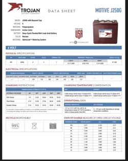

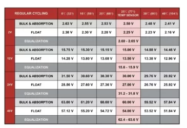

In order to make an informed decision you’ll need to know the float voltage that is specified by the manufacturer of the batteries that you’ve installed at the cabin. Right now, you’re just guessing.
The battery specs all give 13.5 as their float voltage. I am going to check more closely the voltages at my battery. While the charger says 13.8, the actual battery voltages may be less.
I have not had any excessive water usage with my batteries, very little actually. I know that is an indication of over charging. I also have not been on the solar forums for a long time. Will check them out again.

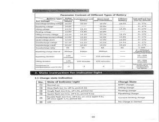

I do find it a little odd that the while the battery specs say 13.5, all the chargers default to 13.8 for their FLA float mode.
FWIW: The float voltage for our L16’s is set at 54.0V. Below is a screenshot which shows the information for the portable 48V charger that we have as a backup. The float voltage is 54.24V.
