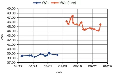

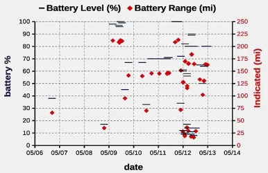

  • Car Battery Management System range at 100%
    • ~173 miles, old
    • ~204 miles, new
Was 30 mile more range worth it? And what did you do with your old battery?
For me, it was worth it. The newer battery restores the 100% SOC range to the low 200s that the earlier battery had expected to reach. A failed valve in the "SuperBottle" probably cooked the old battery over the previous two years. Had I caught that sooner, I probably could have keep the old battery operational for another 4-6 years but 2019 era, NMC chemistry, 2170 cells will always age.

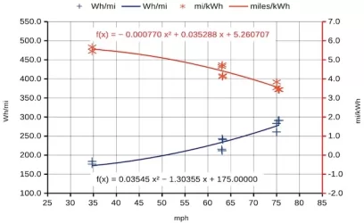

So now my 2019 Model 3 Standard Range Plus has years of additional life with these benchmarks from two days ago:
The price-performance is still worth it to me. There are only two other EVs with higher efficiency at "fueleconomy.gov" and both are way more expensive than my repairs.
