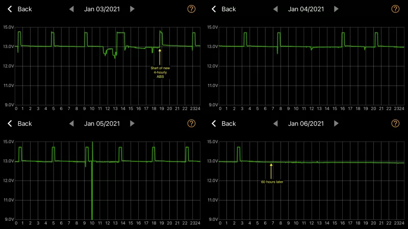

Auxiliary battery voltage dropped from 14.6V to 13.3V.
14.6V is normal charging voltage, I would love to have 13.6V as a resting voltage however mine hovers around 12.7V.
Just keep an eye out for the usual 12 charging pattern
(Thanks to @KiwiME for this picture) :
https://www.insideevsforum.com/community/threads/12v-battery.5090/page-18#post-119304
and you should be good to go.
