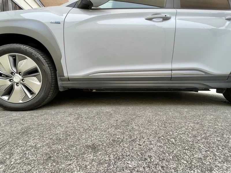

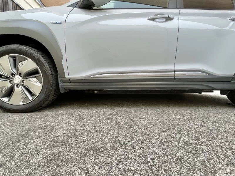

I was just looking at my car in the daylight after having my battery swapped out. There's no doubt that it's a new battery as it's extremely obvious, shiny and possibly hanging down lower than the old one. I don't recall seeing the old one hanging below the running boards so prominently. Anyone else notice differences? Is it just a different (shiny) finish.
*By the way, new battery charges to 358km range at 100%. Identical to the old battery.

Wildeyed, I had the same impression. Fortunately I'd taken a measurement of the clearance between the battery and the floor at the B pillar when I first got the car, in order to see if it would clear the sill of the carport (there is a sloping access), and when I measured with the new battery it was within 2mm. I think we are all more curious about our batteries now!

It looks like a potbellied pig!

See post 220 (mine) on page 11... Followed by an answer by Wildeyed on the very next page, saying that I would get more answers when someone gets their battery replaced. Well, the time has come. :)
What caught my eye were the black brackets you can see at either end of the battery on your photo. I don't remember seeing those before, or maybe it's the shininess of the new battery that made them stand out more. I was never able to get a clear answer on what changed, but I am sure something changed.
I completely forgot about this exchange. I'm on your side. Something about the appearance is different but I'm at a loss to explain what exactly.
John Lumsden above says that it's just a couple millimetres lower so apparently it's all just a cosmetic change and a bit of an illusion.

... the black brackets you can see at either end of the battery on your photo...

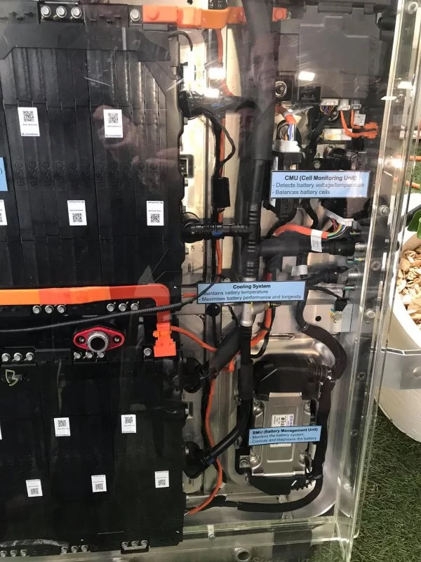

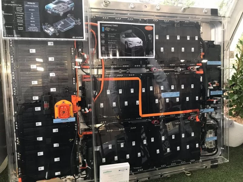

My original battery has a strip of black foam-type tape running the length of the side which hides the aluminium finish. At the front end the splash cover is visible overlapping the end of the battery. At the rear there is a black plastic "bracket" of some sort. It seems perhaps the new battery is missing some of those details.

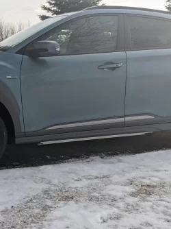

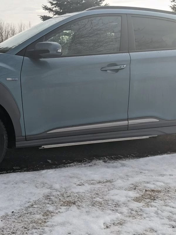

I think you're right. My "before" picture shows a nondescript black sided battery "underhang" while the "after" is plain, polished metal.
P.S. my goodness your car is clean! :)
P.P.S. I was just browsing 2022 inventory on Autotrader and photos clearly show the shiny battery on the new models. I guess all newly manufactured batteries are the same, plain metal.
That picture was helpful. It looks very familiar and I assume this is what mine looked like before. So the new battery DOES look different. Thanks!
