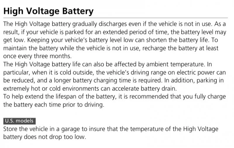

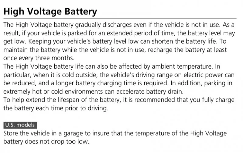

I realize that it's not quite the same thing but when it comes to cell phones it is better to keep them charged between 20-80% rather than to trickle charge them overnight, run them down to zero, charge them back to 100% etc. In fact there are devices available now whereby you can set your charger to actually turn off after 1-2 hrs of charging at 80% (rather than leave it all night). So after fussing over this regarding my new iphone 13 (which costs about 30X less than my Clarity), I started to think that perhaps I should extend my battery neurosis to my car as well.
