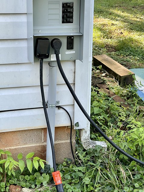

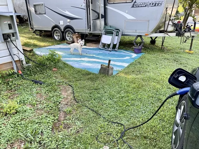

Not worth its own thread, but we’re helping to care for an elderly cousin, and had an RV pedestal installed on her house to power our travel trailer. Below is how we charge using the 50A RV receptacle with adapter, albeit limited to the 13A or so charge rate with the stock EVSE cable. 10 EV miles per hour can be much handier than 4 EV miles per hour for mid-day top offs.

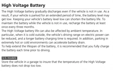

The manual suggests to charge before each drive, meaning there is a benefit to starting a drive at full soc.
Here’s the complete wording from the manual. It actually recommends to recharge the battery “at least every three months” if the vehicle is left to sit unused for an extended period. While it does not define “recharge” it would not be unreasonable, in my opinion, to interpret that to mean a full charge, which the BMS regulates to ~90% or 4.09x VDC per cell.
