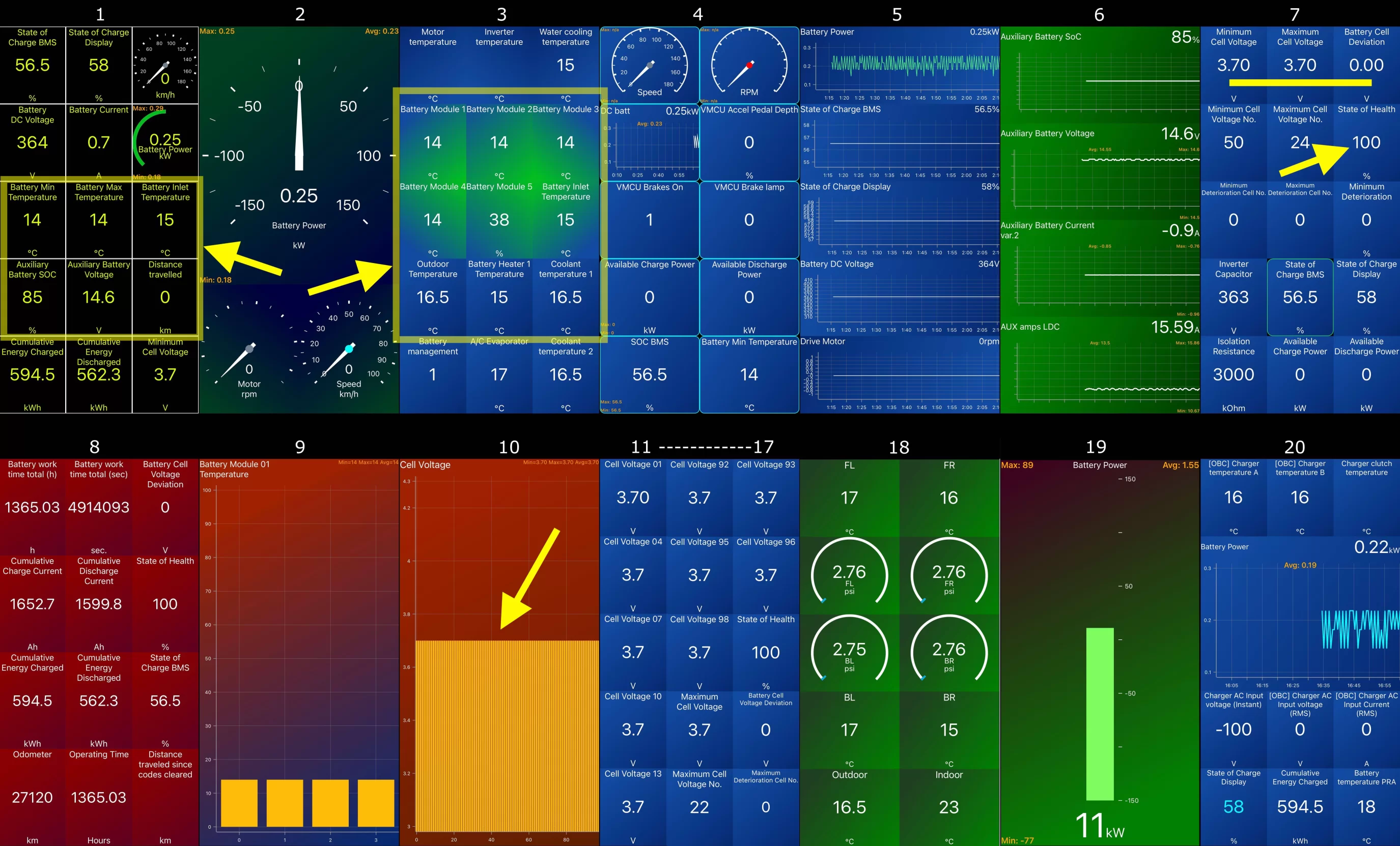

With a OBD dongle and "Car Scanner" phone app you can read the SoH and cell balance.
