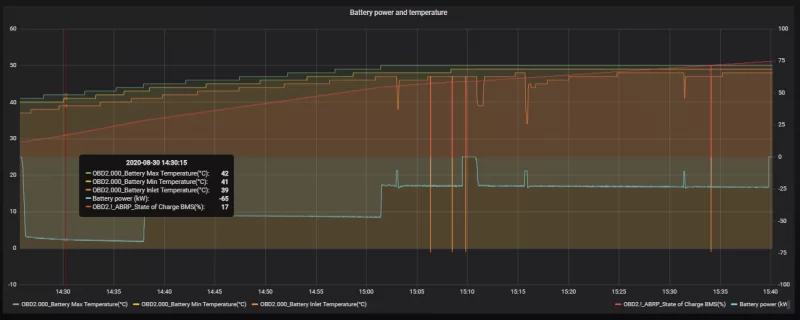

Here is a plot of the temperature profiles while charging. The inlet temperature doesn't drop at all!

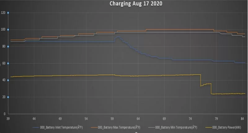

Your battery cooling is definitely faulty.. I have some information on this issue that I can't publicly post. I will send you a PM with the information.. I would definitely bring the car to Hyundai. Attached is a chart how battery cooling should work.. The chillers and water pump should come on at 98.6F/37 Celsius and stay on until the battery max temperature drops below about 35 C..
Here is how cooling should work. My example is in the steamy hot Florida climate... The hottest temperature I have ever seen was 105.9F/41 C.
On most hot summer days, it never goes above 39 degrees... My chart is in degrees Fahrenheit.. Peak temperature was around 100 F/ 37C Celsius.
Thanks for sharing, after the BMS software this is now the behaviour I am observing during fast charge, with the inlet temperature suddenly dropping when the chiller is activated.
Before the update, the inlet temperature was just going up as the battery temperature was going up.
Oh, I just replied to your message before reading this.. If it cools now, no reason to bring it to Hyundai.. Just keep an eye on it..
