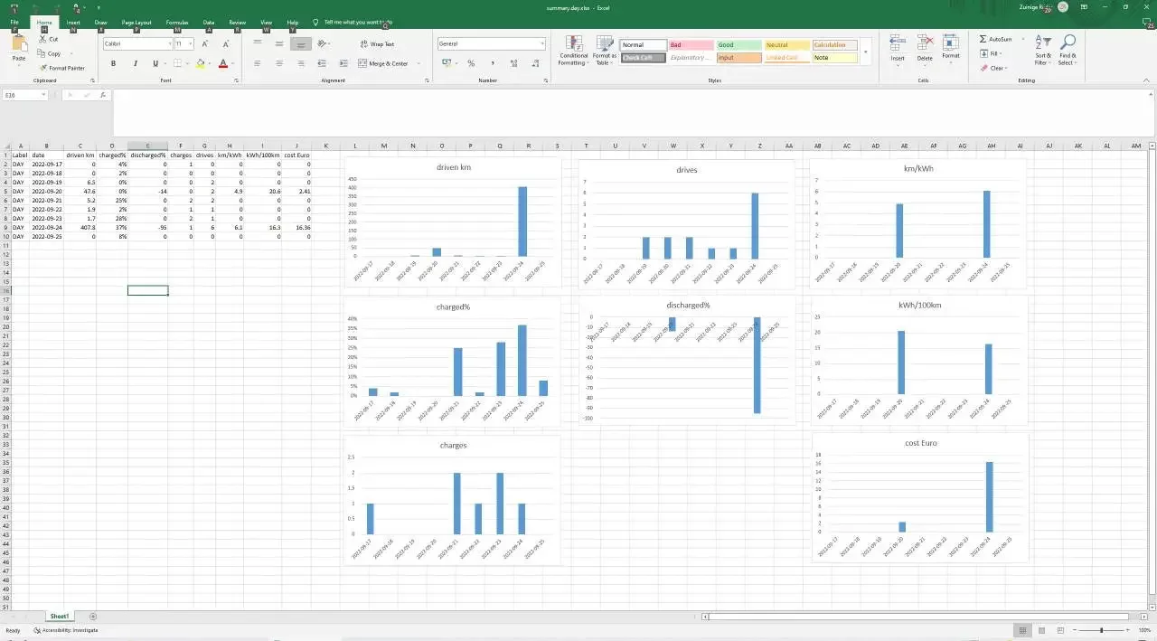

Screenshot of Excel using summary day data:

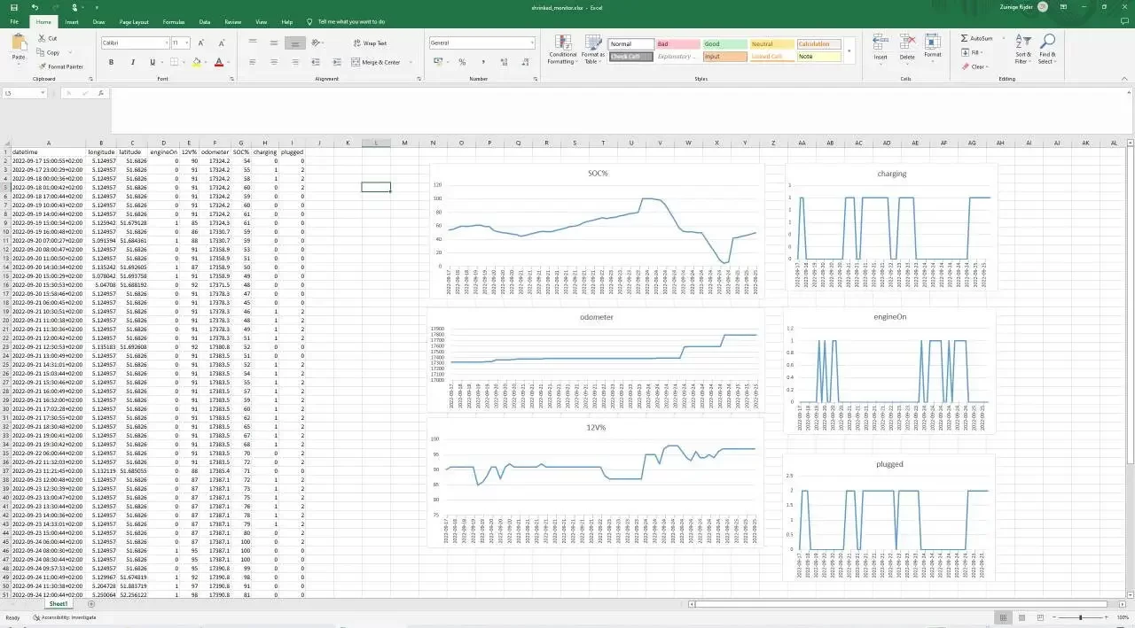

And an Excel example of shrink.py output:

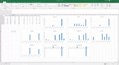

Excel screenshot:
