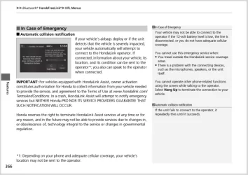

You can see this, and a few more details in the manual (page 366):
What is not clear is whether this function is inherent in the vehicle, or whether it requires the user to have a linked cell phone in order for it to operate. This does appear in the Bluetooth HFL section of the manual, but that is not proof enough for me.

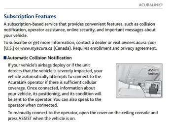

FWIW, I found the equivalent reference in an Acura manual:
In the Acura manual this discussion is in the 'AcuraLink' section (separate from the Bluetooth HFL section), and this wording is a little different with maybe a stronger implication that an external cell phone is not required. But... This is an Acura not a Clarity !
@Lowell_Greenberg found a reference that likely applies to the Clarity, and it does state that a Bluetooth linked cell phone is required...
https://www.dowhonda.com/2016/12/15/hondalink-assist-automatic-emergency-response-system/
I guess that is the answer unless someone finds some alternative facts.
Even the base model has GPS functionality built into the head unit, so your location is known. We also have a TCU built-in. Which can communicate to cell tower(s). However, you might not be able to actually communicate to someone without having a device connected via bluetooth.
Has anyone who has had the unfortunate experience of crashing their car provided any feedback on the actual experience (the connectivity, not the crash!)
Iirc older Acuras used GMs OnStar service, while current Hondas had the "Hondalink Assist" which uses your phones connection to place the call, including the clarity. I think the easiest way to tell if you have the built on system is if there's an "sos" or "assist" button on the upper consoles like Acuras have.
Afaik all Hondas have the cellphone dependent system. The systems that have it built into the car will have a yearly charge.
