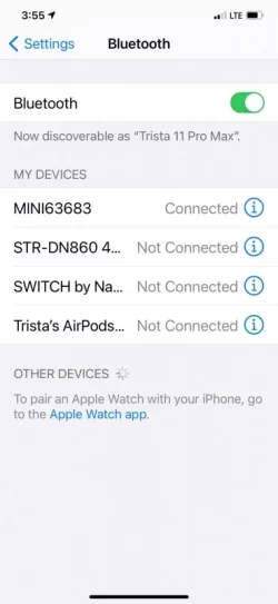

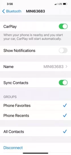

I successfully connected my iphone (11 Pro Max) to the car for Apple CarPlay. I'm running iOS 14.something. Saw it on screen (full-screen on 8.8" display). Then added fiance's iphone (running older iOS). Success. But then asked dealer how to switch from his phone back to mine. Couldn't get it to reconnect to my phone. Turned his bluetooth off, same issue. I can connect with the basic bluetooth phone/audio functions.

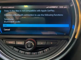

"Forgot" the mini connection so to try to add again as a new connection. Now it's saying my phone is not compatible with Apple CarPlay. Except that worked 10 minutes earlier. Tried it again today and still not working. Dealer couldn't figure it out, either.

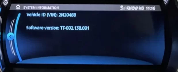

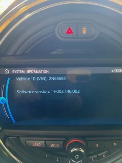

Adding: I have a different software version than @TittaPDX

Happily my CarPlay functionality magically reappeared. I had to delete my phone (paired as bluetooth phone) and reconnect it as CarPlay, but now I have full functionality again.
