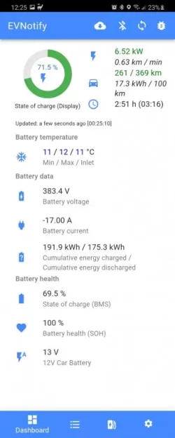

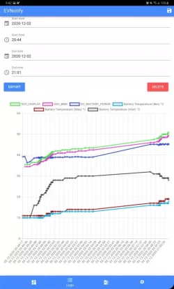

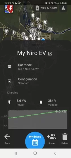

I've also found a good one called EVNotify for Android. Here are some recent screen caps. It also intergrates well with A Better Route Planner for EVs.
