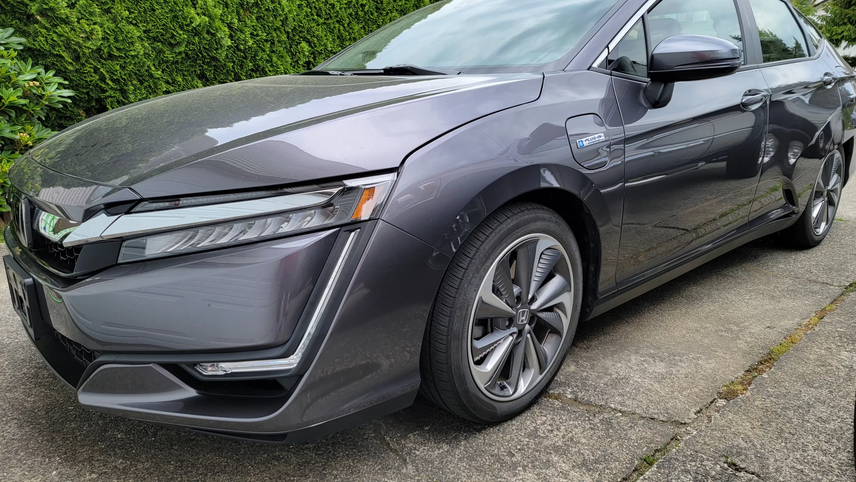

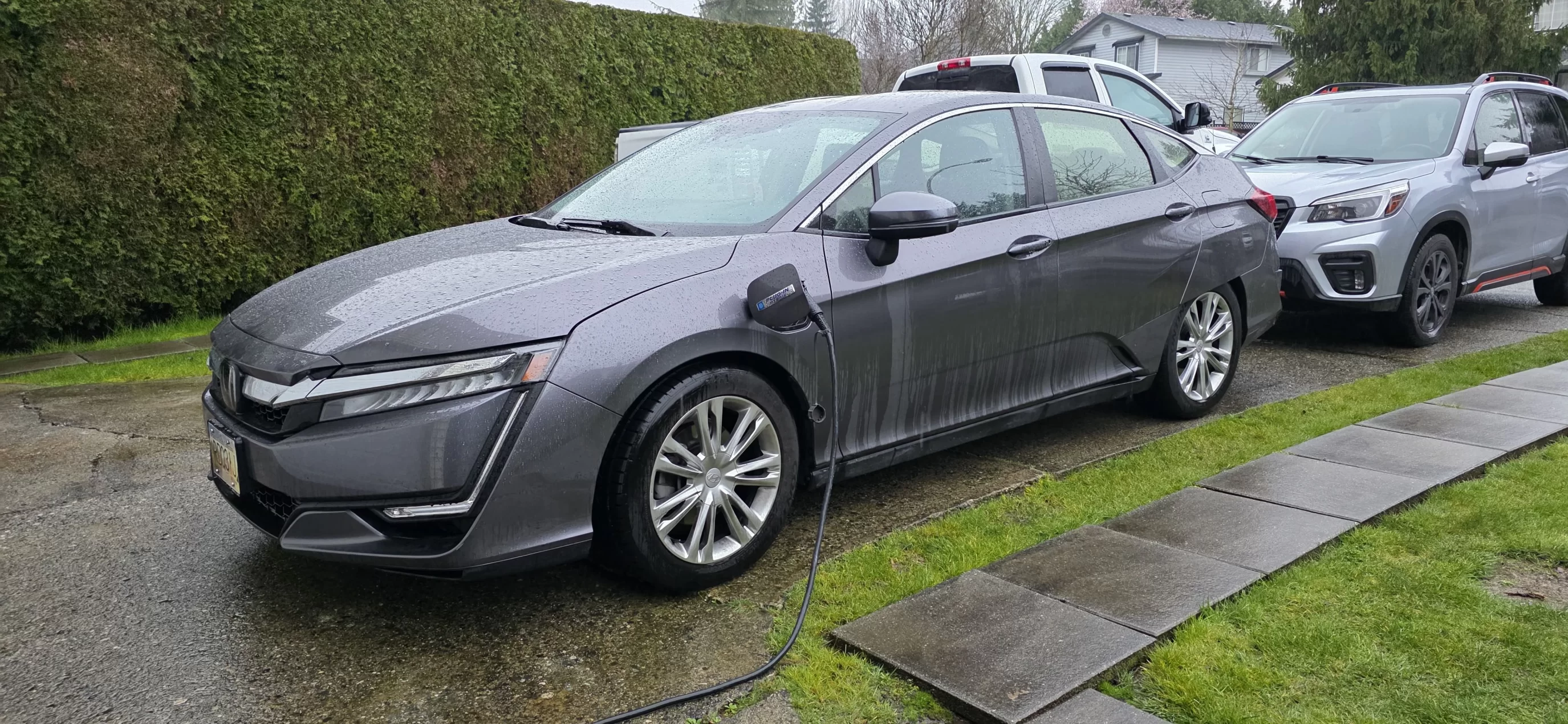

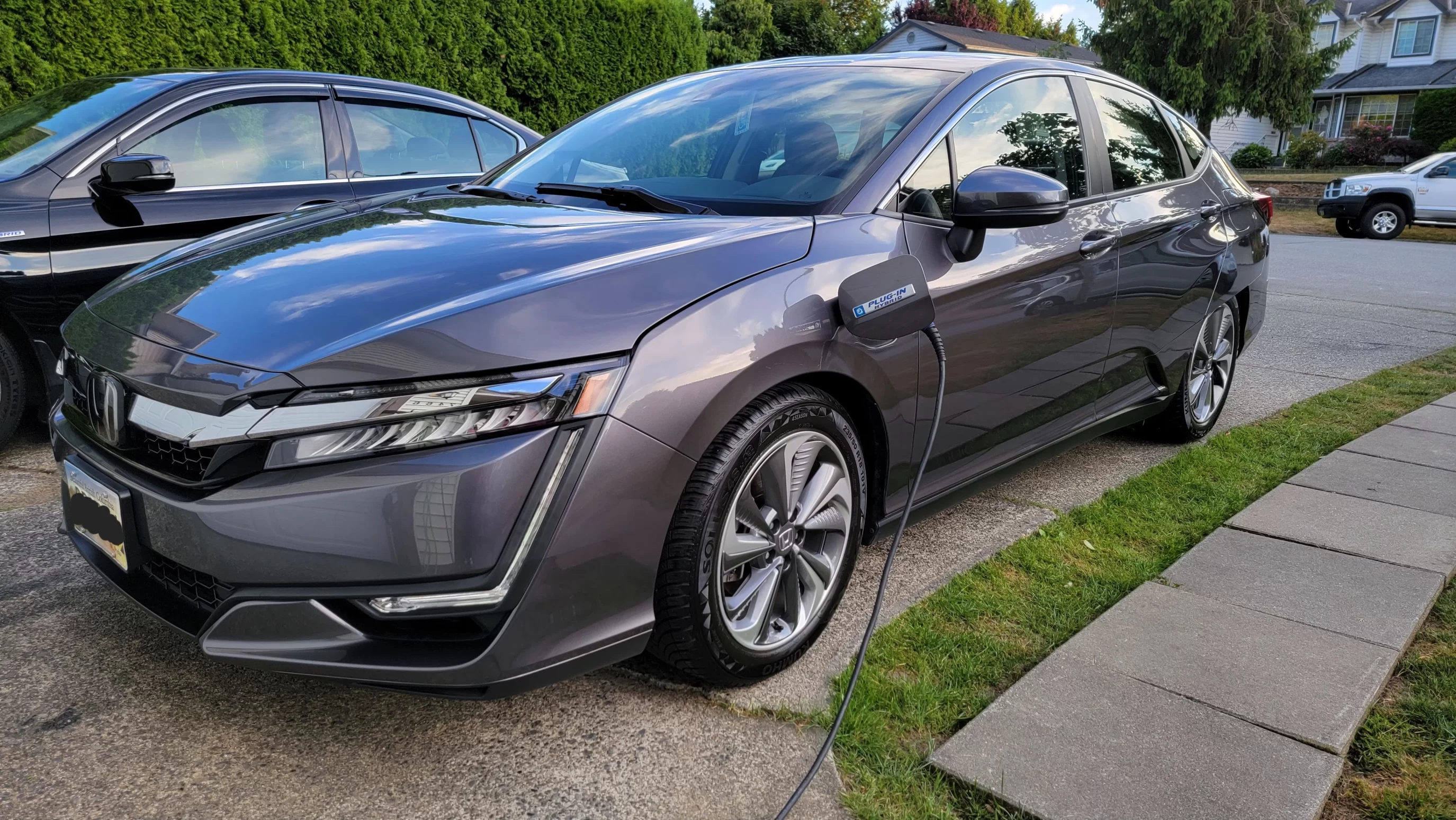

Running Hyundai rims. Any particular reason you would need to change the rims with this tire size change?
I ran 235 50 18 Kumho ha32 on stock rims in 2nd picture
Just had Hyundai rims so tried them with continental dws06 235 50 18

Conti ride noticeably stiffer than Kumho but driving confidence is better
