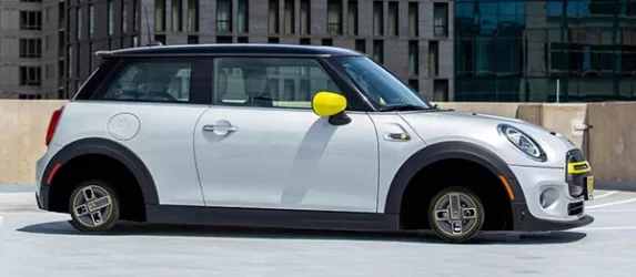

Four years ago, I used Photoshop to explore the look of tiny Power Spoke wheels on a MINI Cooper SE. Braking would suffer from both tiny discs and tiny tire contact patches. The car's cornering would be terrible:
