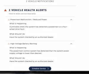

Anyone had these error messages (and MME dies then)?
Mach-E21
- Powertrain Malfunction/Reduced Power
- High-Voltage Battery Warning
After above messages, error messages for every function started popping up. Then MME completely died.
