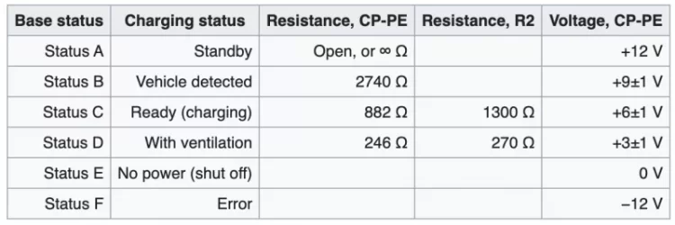

Middle of the night realised that this is not true, my EVSE sits at Status A or B when left plugged in waiting for the car's timer. That means the contactor is open and it may or may not be advertising the available current, not that it matters. And the documentation says it does a G-N test, which I can see it completes only on each power-on.Once the EV is detected and the ground test completes (if any) there is no reason not to proceed to C, irrespective of whether current is drawn. It is the EV's business alone what and when it takes advantage of the available maximum offered current. The EVSE should sit there forever waiting, ...

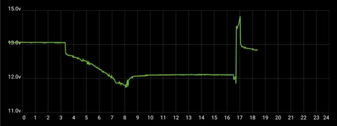

I was able to link up with an engineer from Enel X (successor to AeroVironment). Since the EVSE-RS is JuiceNet enabled, he was able to read the logs, and saw a large number of PlugIn/PlugOut events. But the PlugOut events typically lasted a few hours. They might trigger the discharge behavior, but they're not recording it.
The on-off loop takes about 24 seconds. Here's what it looks like:
He thought it might be a partially inserted charging handle. The handle is solidly inserted, but that doesn't rule out a bad contact. After one dead battery a month ago, the 12v discharge has recurred three times in the past three days, which might suggest a component failure (including a connector).
Now I'm trying the charge cord that came with the car, plugged into 240v, and will give it a day or two to see if the problem recurs.
