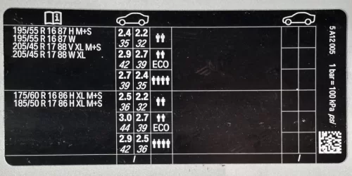

(going to see how the 40/37 psi works out soon, as my tpms pop up on the dash is getting to be distracting.)
This sounds (and feels) exactly what might be going on with the "bump" or "notch" felt in what is otherwise a light-as-a-feather steering feel on my 2023 SE. I did a search for any sort of recalls along these lines, but found nothing. Looking forward to getting this resolved.
Raising pressure to 40/37 PSI is not going to solve an issue with TPMS if you not loosing pressure in tires is something wrong with system and you see dealer soon . 40/37 you will drive like on stones . My 16 “ wheels I keep 35/32 PSI .as factory recommend on doors label.
True. Tire pressures not related to the steering/possible intermediate steering shaft issue. . . I was adding/simply expressing an interest in trying an slightly increased tire pressure for mi/kWhr.
A few weeks ago I went with the "ECO" 42/39 psi pressure from the UK tire plate and it hasn't really seemed to make much difference, at least so far during the summer.
