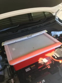

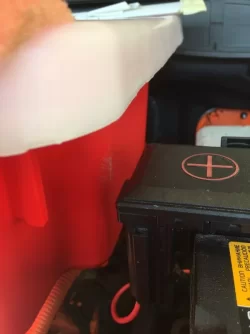

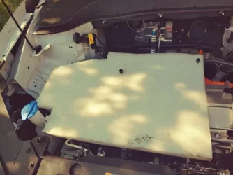

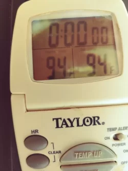

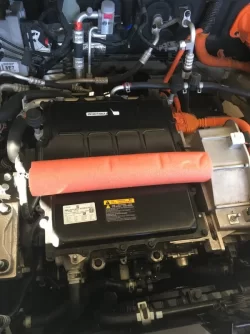

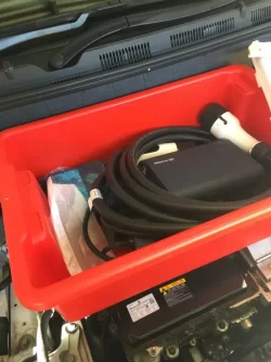

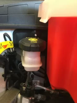

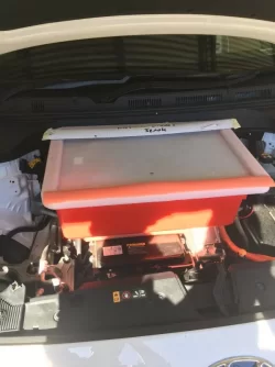

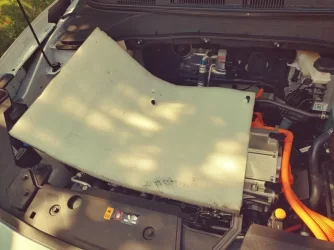

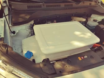

The temperature of the motor never exceeds 94 F. I checked it with a remote temp probe. I built a self mounting container in a few minutes (see photos, I hope).
I used a stiff sponge plastic and glued a container on it. 20190928_120445.webp
20190926_123121_HDR.webp 20190926_123121_HDR.webp 20190926_123348_HDR.webp 20190926_124914_HDR.webp 20190928_120445.webp

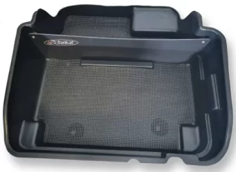

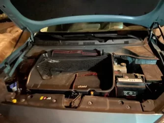

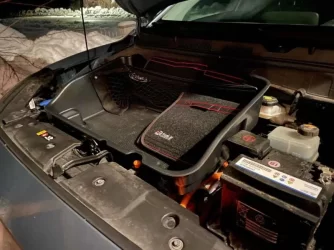

I just installed my Frunk using the instructions from . This used some 3d printed parts that are available at https://www.thingiverse.com/thing:4065215. My local public library has a 3d printer and charged my $.06/gram. The set of four printed parts cost $6.75. This is wonderful, and now I can carry emergency gear up front, including jumper cables (which you can't get to in the back if the 12v battery is dead!). (2019 Kona e). The 3d print site has slight adjustments for the later year products.
I'm re posting this. It's worked for me for 40,000kms, including off roading in our local National Park.
My dealer has seen it and made no comment. I store all my spare cables and equipment to clean the windscreen + a bottle of water.
