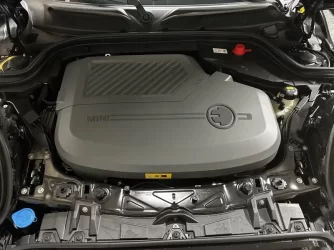

Thank you for the add'l clarification! So I popped the hood and took a look around and it wasn't apparently obvious what I should disconnect? I can only assume I need to somehow remove the grey cover? Thank you again for taking the time to walk me through this, much appreciated!
Underneath the big gray cover is the electric motor and heat pump, the 12 V battery is underneath the black cover on the top right. Under that red circular cover is the positive terminal for the 12 V battery.
