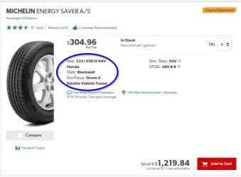

Here is a major vendor (Tire Rack) who sells both. The "EV tuned" is significantly more expensive (18%)
I circled the key part of the description...
I think it may be just the Yokohamas
That’s entirely possible. We’ve had a number of owners report that non-OEM tires provide a quieter ride than the Energy Savers. And most, if not all, of the other tires are not “EV Tuned”.
Another possibility is that the resonators are tuned to the Honda specified Energy Savers, which could make them less effective on other tires.

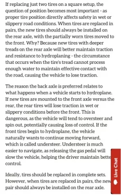

Well, I’m disgusted! I just went to America’s Tire for the third tire rotation of my 2020 Clarity with a little over 15,000 miles, and I was told that the fronts are in the “warning zone” and are too worn to rotate!
Most likely, the shop was implementing a relatively new guideline of mounting the tires with the most tread on the rear axle rather than the front axle. Testing has demonstrated that a driver in a passenger vehicle is more likely to lose control during a rear tire failure than a front tire failure. Hence the change in protocol.
As the details flow in, it is now apparent that the tech at America’s Tires was following industry standards. The septuagenarian at Sam’s Club was either going rogue, or Sam isn’t following industry standards.

To be clear, I’m not suggesting when tires should be replaced. I’m simply sharing with you, a recommendation based on facts and data, as to where tires with more tread should be positioned on a vehicle. If you view that recommendation as a conspiracy, it isn’t likely that anyone will change your mind.
Additionally, this isn’t the place to debate the overall health of Americans or their healthcare choices. That said, the trend is to consume mass quantities and then take a pill to make everything ok. It’s the best of both worlds. Why fight it? (Sarcasm)
This is from TireRack. In many cases you will see this information posed at a tire shop or in the service department of a car dealer. It can also be found on the websites of tire manufacturers and insurance companies.
This very well could be a conspiracy. Perhaps to sell more tires or to see if people will do stupid things. We know they will, often without any prompting.
On the flip side, tire manufacturers, auto makers and professional drivers have conducted tests and their conclusion is to recommend that tires with the most tread remaining be installed on the rear axle.
Yes, this information specifically addresses the installation of 2 new tires. The same principle applies when rotating tires where 2 tires have more tread than the other 2. A tire shop will likely leave the tires with more tread on the rear axle.
