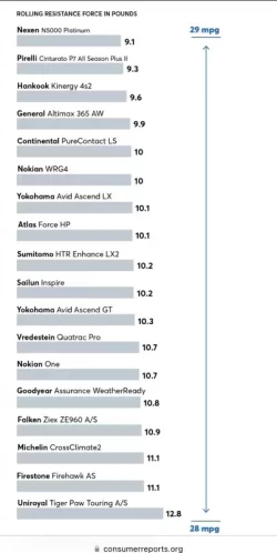

I tried to attach the screen shot from CR but it failed. I found it by searching for low rolling resistance tires.

Without a standard, meaningful comparisons can be elusive. CR also limited their testing to “Performance” tires. Is there a standard for that?
Interestingly, they included the Michelin Cross Climate 2 in the test. This is a tire that some members of this forum are using. If I recall, it is one of the tires that has reportedly reduced efficiency compared to in the OEM tires. Looking at the chart from the CR testing procedure, we see the Nexus tire at 9.1 and the Michelin tire at 11.1. There is one tire that is a bit of an outlier which comes in at 12.8. The chart also shows the range of 9.1 to 12.8, corresponds to 29mpg and 28mpg respectively. This would put the Michelin tire very close to the middle, or 28.5mpg. That would make the Nexus 5000 approximately 2% more efficient than the Michelin CC2. The CC2, however, may be 8-10% less efficient than the Energy Saver A/S, which theoretically would make the Nexus tire 6-8% less efficient than the OEM tire.
A couple of things we don’t know are the weight of the test vehicle or the tire size used for the testing. Both factors could produce different results than if the test vehicle weighed 4000lbs and was equipped with 235/45-R18 tires. It’s a half baked report, which is why I put little value on the results.

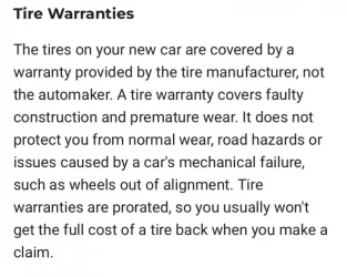

Here’s a generic blurb on tire warranties. Since they are OEM, meaning you didn’t purchase the tires separately, a warranty claim may need to start at a Honda dealer, even though Michelin handles the claim. IMG_2796.jpeg
