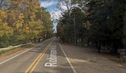

In this case...the Clarity had clear sailing ahead as it were. I believe the sudden appearance of an object regardless of position relative to the Clarity activated the CMBS...which it is designed to do as I understand it.
Anywho...it worked this go-a-round.

On my way home Monday afternoon I drove this stretch of road. When I approached the narrow part the CMBS beeped, shook the wheel, and displayed BRAKE. Straight road, no traffic either direction. LKAS and Road Departure were both off. CMBS would have been off too if I had remembered to turn it off when I started for home.
FCW (forward collision warning) can be triggered by a falling leaf and a shadow in the wrong place for a moment, and I've had it happen a couple times, but those both of those obviously move relative to the car as it moves, so they don't actually trigger the car to brake on its own.
