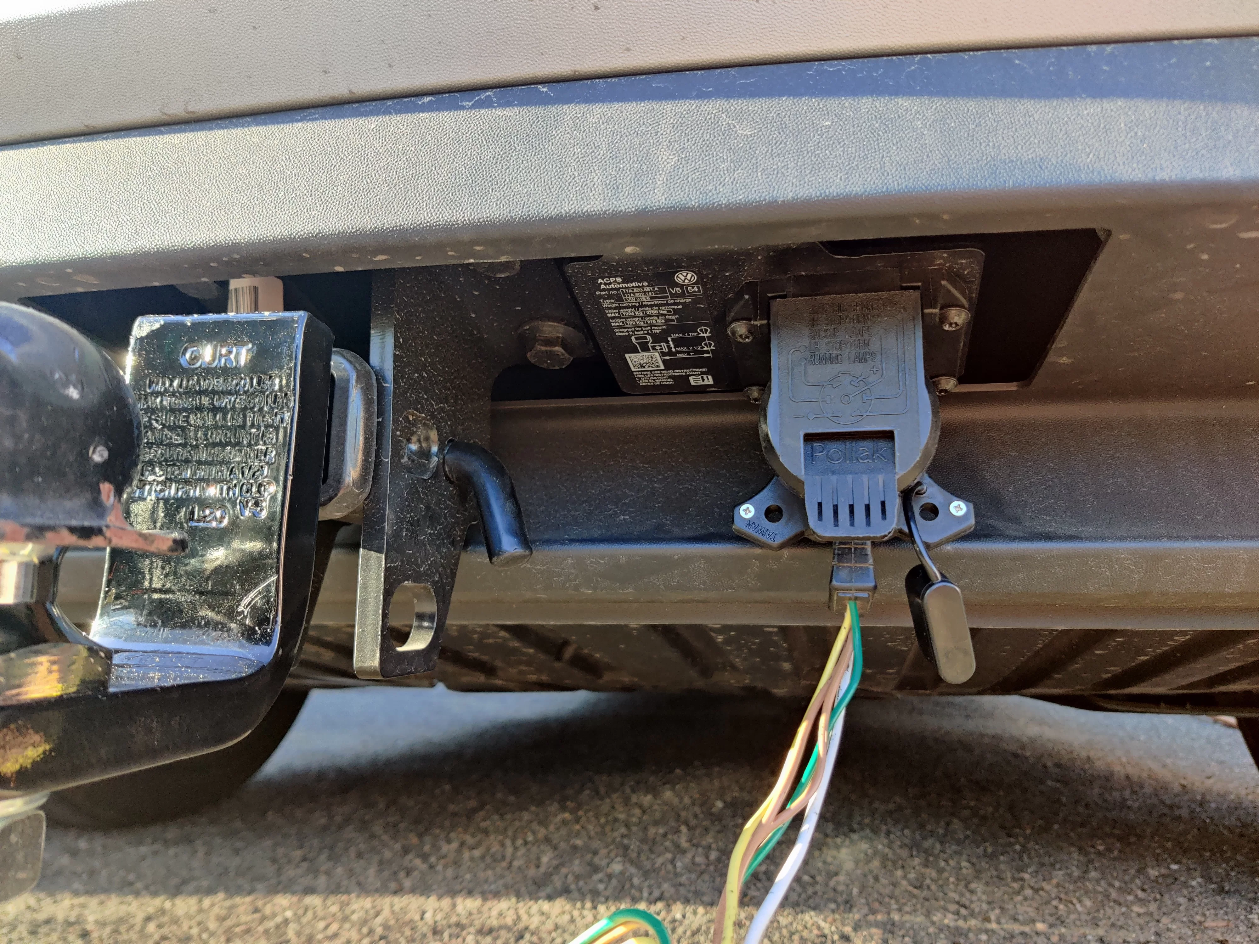

Here's the parts we got:
7-pin socket: https://www.etrailer.com/Wiring/Pollak/PK11893.html It says it is not confirmed to fit an ID.4 - but I am confirming it fits exactly, because it is the exact same part made by the same company, that VW sells.
4-pin adapter: https://www.etrailer.com/Wiring/Pollak/PK12716.html The tab on the side of the adapter holds it in place with the spring loaded cover of the socket.
This is the draw bar: https://www.etrailer.com/Trailer-Hitch-Ball-Mount/Curt/C45017.html It is under the 7" maximum length that VW specifies. There are a number of tow bars that are a fraction longer than 7", and I can't imagine they will not work very well, but I figured staying under the max is good.

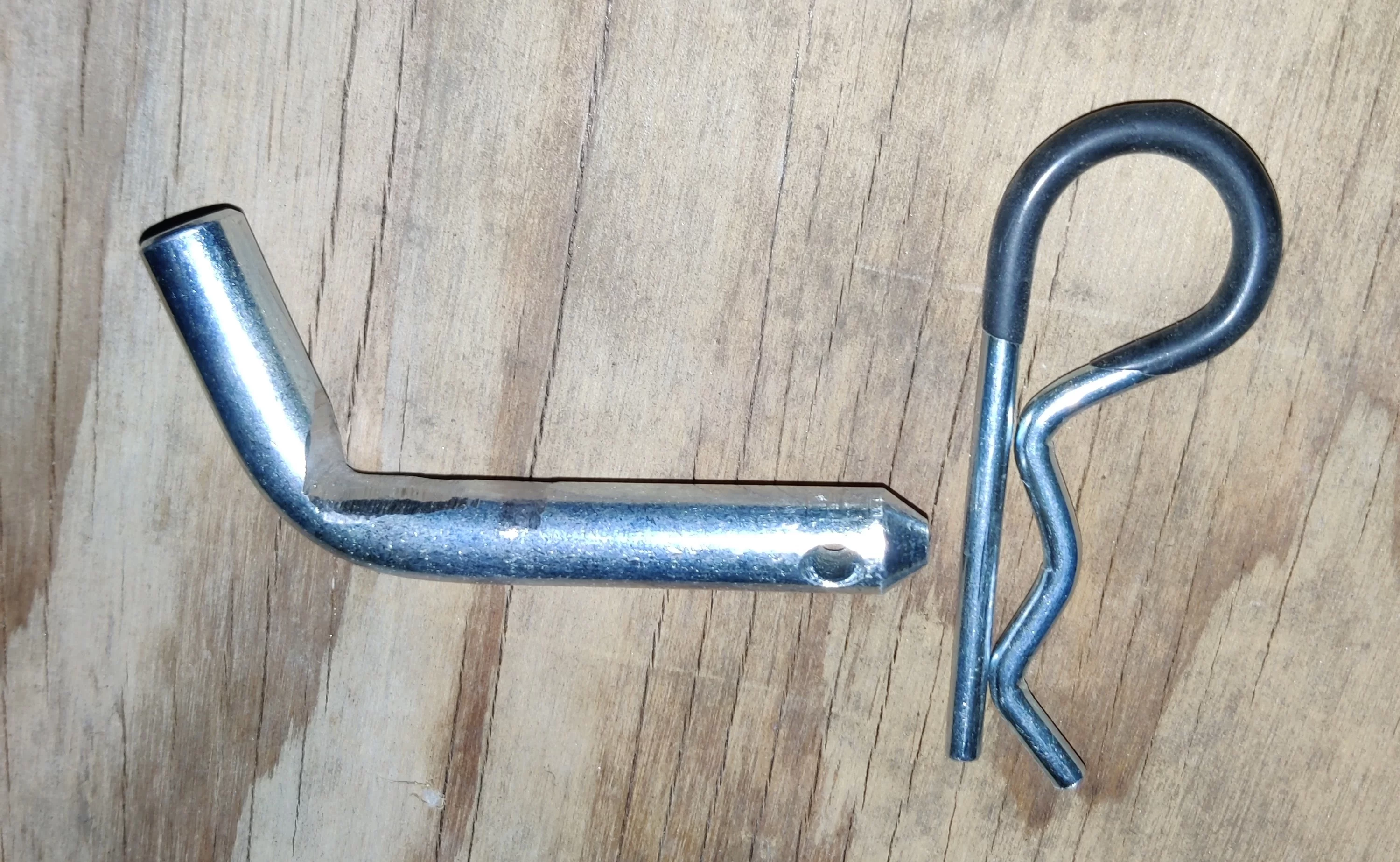

This is the pin that is too short, so if you can find a 1/2" x 2 1/2" (or a bit longer), then that is easier: https://www.etrailer.com/Hitch-Pins-and-Clips/Curt/C21410.html
We got a 1 7/8" ball: https://www.etrailer.com/Trailer-Hitch-Ball/Curt/C40001.html A 2" ball will also fit, if that is what you need.
The pin is still just as strong in shear as it was - the bend is still much stronger than the Clovis pin on the other end. All they are doing is holding the shear pin in place.

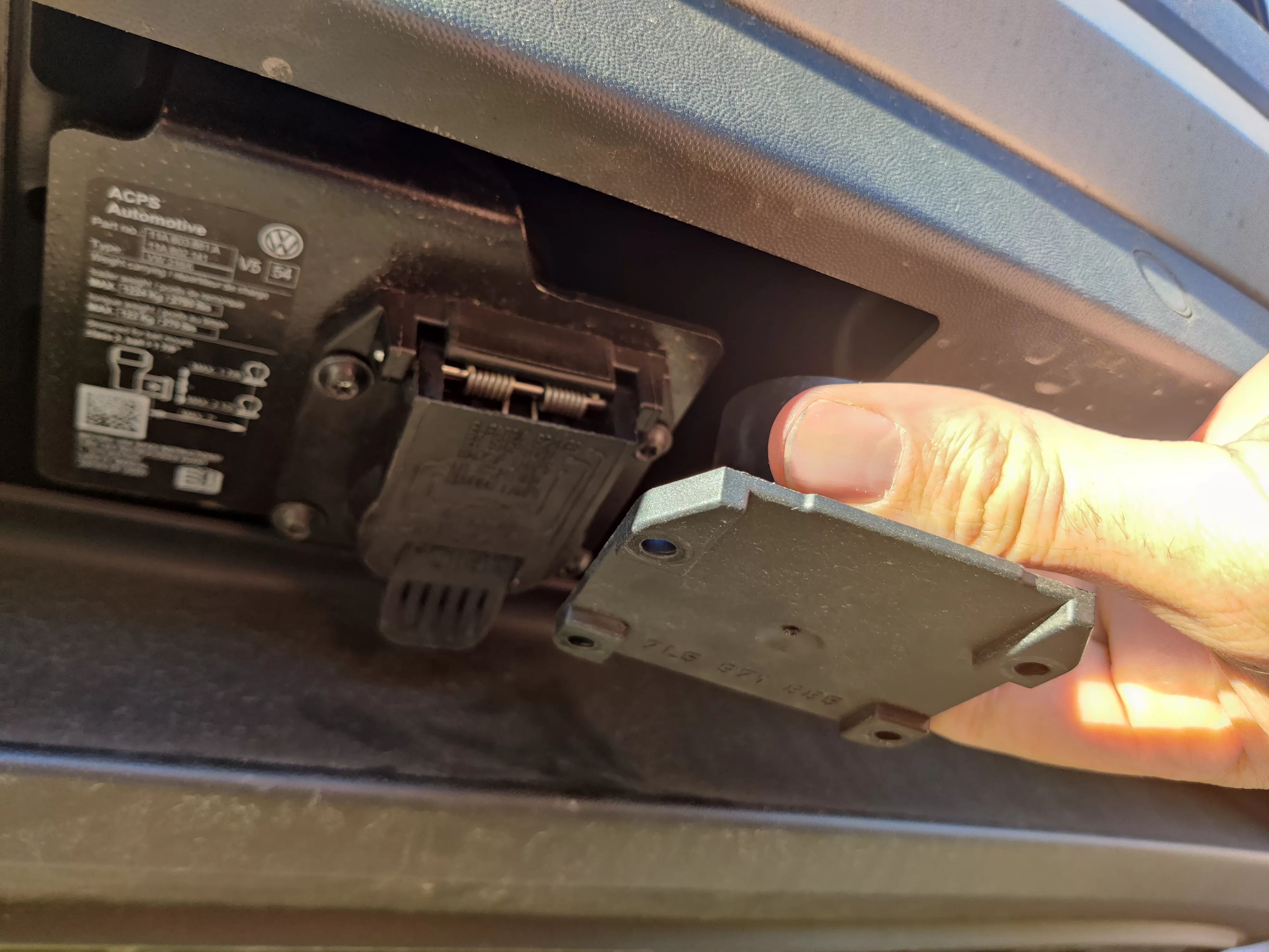

Question on removing the cover plate, I removed the 4 screws, pulled down on the cover, can extract it partially, had to turn it to align the notch , but can't seem to disconnect the cover plate housing from the wiring harness/plug-in?
Is there some trick to it, or just pull harder???
Thanks!!!
Yeah, there is a release button that you need to find. If you get a good flashlight in there you should be able to spot it. I dont remember which way you need to apply pressure.

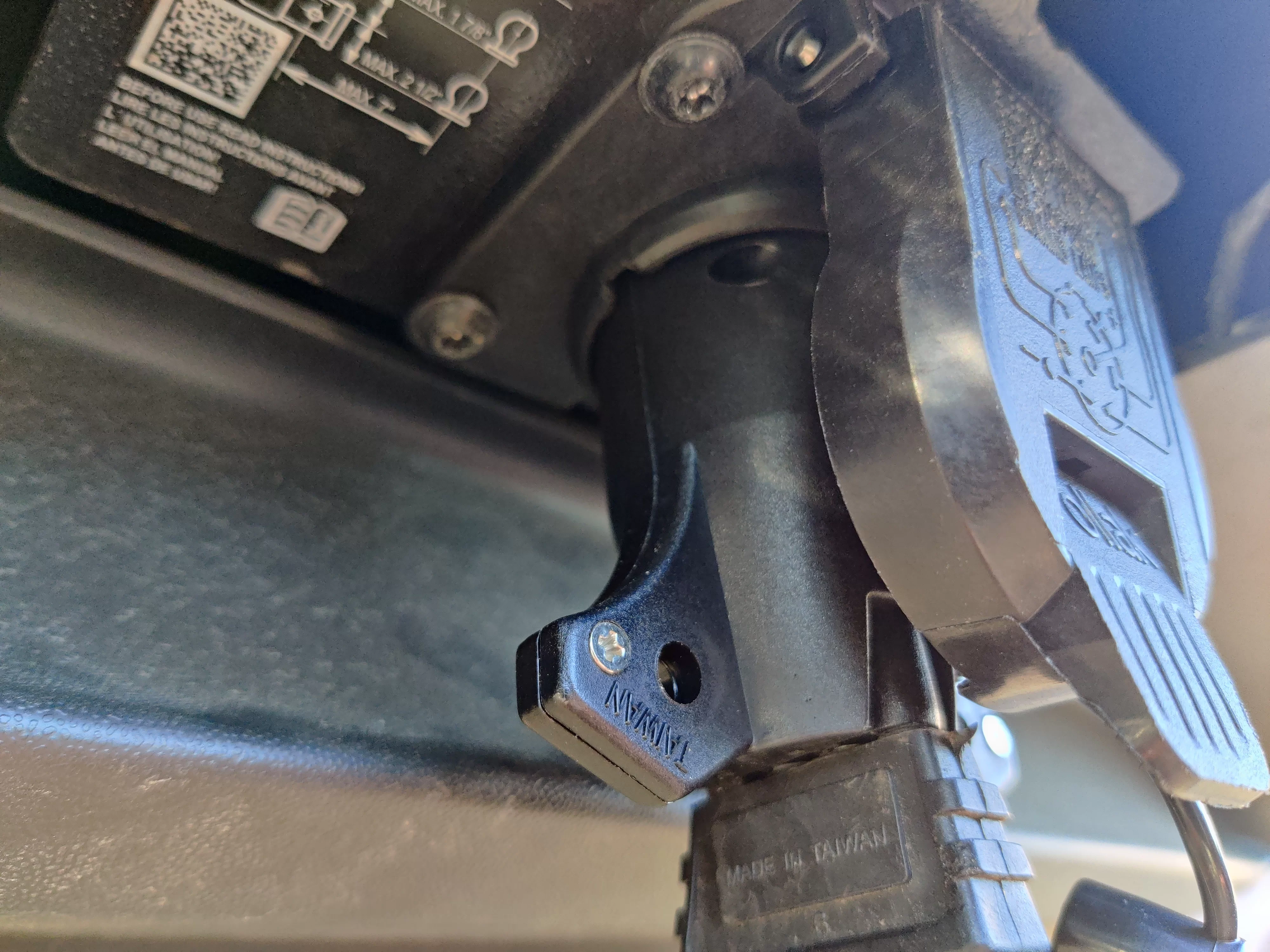

I did the same wiring routine last week.
The red release tab, it’s towards the upper end of the socket, push it upwards with a flat blade screwdriver. Then the parts will separate.

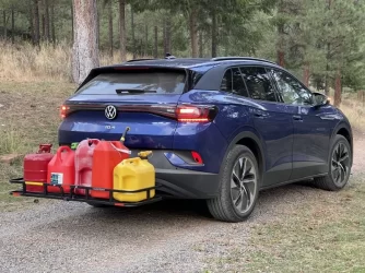

I’ll be towing a 12’x6’ flatbed, but so far I’ve just used the receiver to carry a steel basket for 3 to 5 gas cans (for our 12 ICE vehicles and tools).

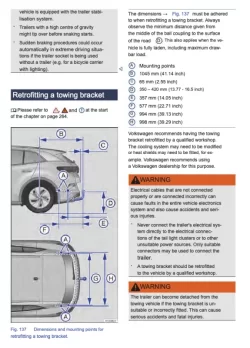

I know this is really old thread, but does anyone know if the length of 7" is a minimum, maximum or simply a recommendation. I am not finding a ball mount with the right rise to meet Uhaul trailer recommendation of 18.5" (middle of ball). This is complicated by the fact that different retailers and ball mount mfg's use different criteria for length (some are overall length, some are from pin center to ball center).
I found in the manual where it has some dimensions listed for hitch retrofit but even there it doesn't specify if anything is a minimum or maximum.
ETrailer.com told me the length is not critical for tongue weight (moment arm). They said it's just an issue if you have too long of a mount, and it is sagging, you'll be closer to hitting the pavement.
