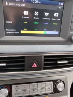

With just the air vent on, sometimes the air coming out of it is cold and dehumidified but the A/C is NOT on. And it is not on the defrost option. This does not happen every time. And, to undo it, I have to toggle the air vent on and off. And sometimes that does not cut off the A/C.
When this happens, I have confirmed that indeed the A/C was working by looking at the menu option for the electrical distribution (when the vent is on and I am getting dehumidified air, it shows power being used by the Climate system).
Any thoughts from folks?

Below is a picture of the control panel showing A/C is on (under the Climate readout) but I only have the vent on. Turning the OFF button will shut off the vent (and of course any A/C). Pressing the OFF button on and off does not stop the A/C from turning on with the vent.
I did read elsewhere that turning the AUTO button on and off can get this to stop; haven't been able to try this yet. I hope it will work, because this is an unnecessary use of the A/C. If I want the A/C I'll put it on. I don't want my range depleted b/c of this. I had that problem (unknowingly) on our first long road trip where I needed to use an interim charger -- our range had depleted way sooner than expected when we were just using vented air.
