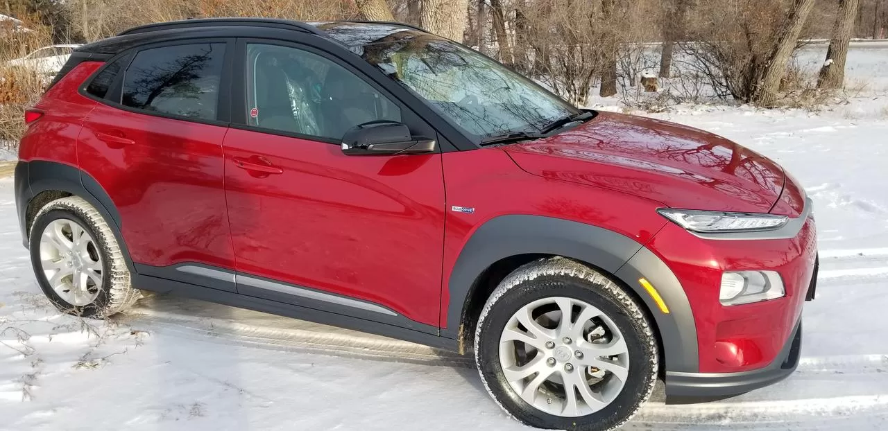

My Kona with winter boots on:
nice wheels!!
Yeah, I think the more chunky thicker spoke wheels like this suit the car better than the more commonly-chosen thin spoke types.

I agree the thicker spoked wheels look really good.
