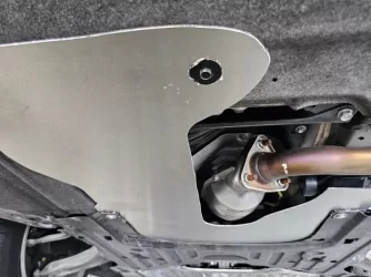

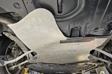

Hello Clarity owners. I just installed some aluminum panels onto my Honda Clarity to help reduce the risk of catalytic converter theft and improve the aerodynamics.
I utilized the original holes with rivets/steel zip ties, or original mounting hardware as applicable. The rear portion covers some unaerodynamic areas, including the fuel tank/muffler.
So far I have not gotten any rattles or negative impacts. I'll update in a few weeks with my observed efficiency impacts.
I've included a poll so y'all can submit your opinions on it.
Looks nice but unfortunately I would guess anyone stealing catalytic converters on the street is doing it with a cordless angle grinder (unbolting the flanges later) and your aluminum panel will add about 10 seconds to the removal process.
