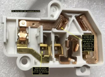

When I think about the issues raised by Munro with the NEMA outlet and circuit breaker, it's clear to me that the problem may arise where a set screw clamp is made directly on stranded wires, or the set screw is accompanied by a plate to effect a parallel-acting clamp. The wire strands are ductile and need a more circumferential clamp that applies an even radial compressive force on the bundle. The set screw works onto a small area and will not be able to maintain tension over a long period, as in years. A parallel clamp partly relies on the strands not unwinding under pressure. Neither have much springiness to help maintain contact.
Much is said about the plug and receptacle contact resistance increasing with repeated use but I suspect problems in that area are less common. Those parts are designed specifically to maintain continuous contact pressure and the materials are selected to have suitable properties.
The EV itself has no such issues because all connections are machine-crimped circumferentially to controlled dimensions. Related plug and socket connections are similarly made to high standards, and despite sitting for years undisturbed, don't exhibit issues. Industry is full of electrical connection examples that work just fine.
This could be more a failure of the relevant domestic N. American electrical standards, product design and quality control, that EVs have simply brought to the surface due to the essentially-continuous loading.
Tests I did some time ago when I found one 10A AU/NZ extension cord plug getting warmer than the others indicated the problem was from a poor quality crimp buried inside the molded plug. These were made of material that was probably too thin, not crimped in a controlled manner and then soldered as well, which alters the material characteristics. Heat generated by the resistance of the soldered joint can't easily escape through the plastic so travels both up the copper wire and down the plug pin. But the latter has only a physically small contact to the receptacle and can't conduct much heat out. Heat going up the wire adds to the warming already present due to wire resistance, so the cord gets warmer near the plug.
I measured the actual pin and socket electrical resistance and found no problems with that, all were 4.4 milliohm.
All wires in N.A. larger than #10 AWG are stranded typically 7 strands for building wire, any competent electrician will use a quality flat bladed screwdriver to tighten the connection first (better yet a hex Allen key), then move the wire around to seat it properly, then re-tighten the termination to achieve a permanent solid bond. By permanent, I mean to say under continuous (as well as intermittent loads where the conductor expands and contracts due to current requirements) will last ~10 years or more before a re-tightening is required. I typically carry a specific set of screwdrivers strictly used for larger wire terminations.
