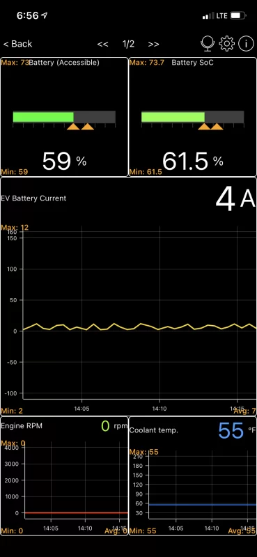

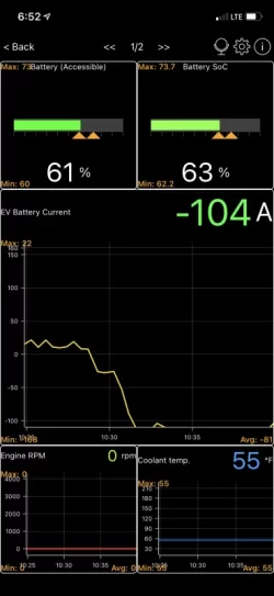

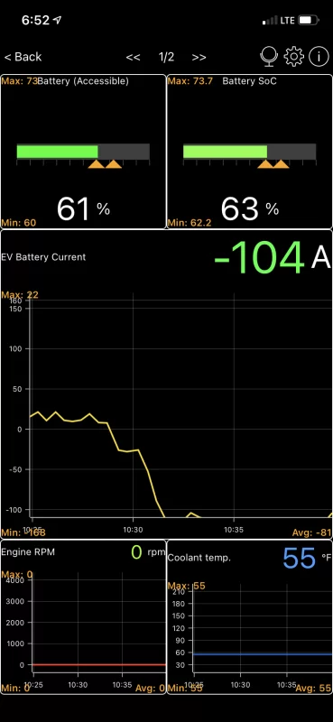

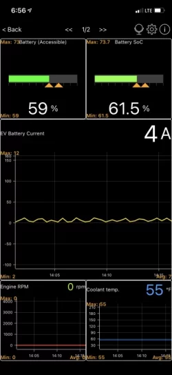

Get a generic ODB adapter from eBay for like $2-$20 range. Use your phone to monitor the data.
I have an iPhone so I got a Viecar Bluetooth 4.0 compatible ODB adapter and it’s working mostly great with Car Scanner app.
On highway cruising it pulls around 60amp, on hills or fast acceleration it can be around 230amp. Downhill regen also shows sometimes up to 200amp going back to the battery. AC uses about 10amp, heater 5-20amp. See my screen captures of my setup.
At 311V.
One is with heater and AC on while waiting, and the other is coming off a hwy ramp to a stop (regen brakes).
On highway cruising it pulls around 60amp, on hills or fast acceleration it can be around 230amp. Downhill regen also shows sometimes up to 200amp going back to the battery. AC uses about 10amp, heater 5-20amp. I can share a screen capture of my setup.
