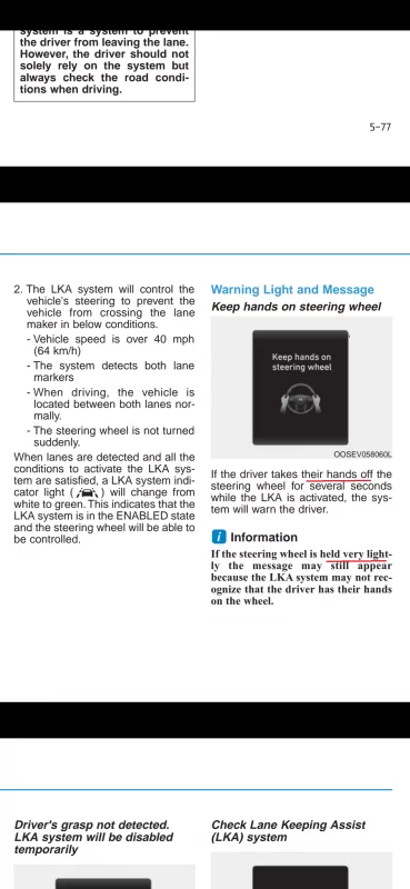

It's not looking for hands gripping, it's looking for slight resistamnce to its steering movements. A slight lean on the wheel keeps it happy.
Right. You can place a finger on the wheel spoke and just push it down a bit every ten seconds to tell kona your hands are on wheel. Gripping it doesn’t help, only torque is detected and it doesn’t take much

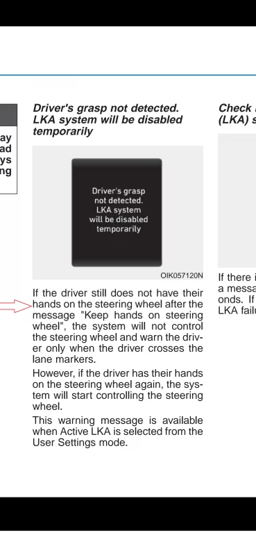

Well, to help myself, I went to the dealership to double check the sensor, or motion question. The parts diagram does NOT show any sensor,so it's odd my "death grip" has enough forward/backward "movement" [think hanging on for dear life] for the LKA to return when I don't actually turn the steering wheel left/right.
