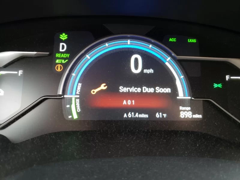

Another point for MM. I had my MM popped up last week stating A1 is needed soon (4 weeks to next service) at 6500 miles. I had my tires rotated at a friend's garage and reset the 1, checking the MM again shows 5 months which also corresponding to 12 months since I bought the Clarity. It does look like the A is shown every time there's a need for other services (like "1" for tire rotation). So if you do this, no need for oil change so early (I only had 20 gallons burned).
That's really good information @Atlantn. I thought that once it called for an "A1" then resetting the "1" would not change the date for the upcoming "A" service that was already signaled. So now this confirms, that yes, resetting "1" will indeed defer the "A" companion flag until the 12 month requirement, or whatever the next upcoming trigger would be.
However, the algorithm seems to take into account the running time, work load history, and temperature history of the ICE as well as trying to minimize dealer service instances. The one year change interval, even with very low miles, is not unreasonable at all.

That could well be, Leo. However, it appears that most, if not all triggers for the oil change "A" flag came about by the tire change demand as you noted. Everyone who reset the tire rotation saw the "A" oil change delayed by months, and typically to the 12 month anniversary of the car, when the oil should be changed no matter what. I don't think there has been any instances I can point to where an oil change came about purely by usage of the engine - at least that we can conclude.
On our old CRV, it gives the oil life % estimate - if this car did it, I suspect that most would be in the 75-90% oil life by the time the 12 month necessary oil change comes up. But it is all just speculation on my part. I think someone had their oil chemistry analyzed and posted here somewhere.

I've read this whole post and others as well. My car is telling me to do a A01 service. My second at roughly 13000 miles. I drive mostly electric. If I just do a tire rotation, not at a dealer, and reset just the 1 portion of the MM, then my oil change will be delayed but not inappropriately so? I guess my question is rooted in that I do want to do my oil changes when I should so I don't want to try to delay the oil change in my car for it to not remind me when I actually should do it. Any help would be appreciated.
EDIT: but I definitely don't want to do oil changes when I don't need to. Better for the environment and my wallet.

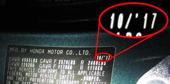

Noticed my service soon is 8 weeks, putting me into March. Bought end of July and currently has 5500 miles, with less than 20 gallons total added. Never figured out my manufacturing date. At least dealer gives free oil changes for life and rotation is about $10
Look on the black info panel on the driver's door opening. Our Clarity was manufactured in October, 2017:
