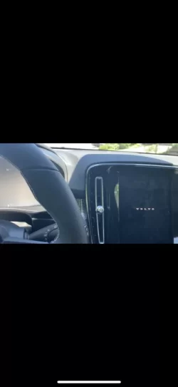

In my case, whole car rebooted in middle of the traffic awhile car is still moving on the way to dealer to fix this issue and suddenly AC start working again, I captured the video when this happened. I will try to post video online.B2BBC0F1-D734-4EA5-A54E-BEED1EBC6460.webp
