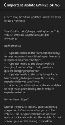

Update has been released that seems to resolve most issues with HVAC:

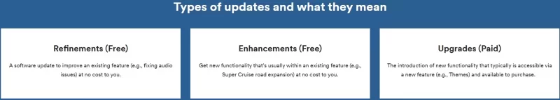

How does Cadillac decide which updates the owner has to pay for? I'm sure many more Lyriq owners would pay to get their AC working than would pay $1,200 to get to 60 mph 0.3 seconds quicker.
