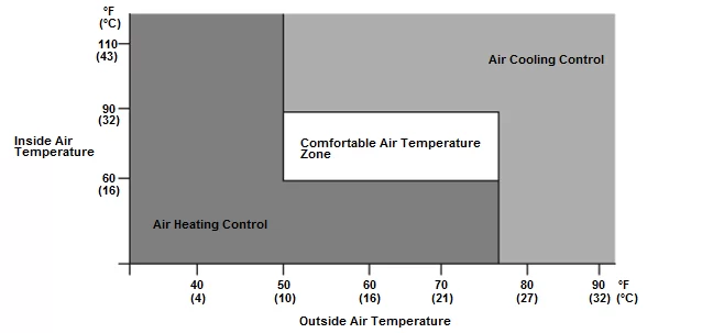

I can’t find it, but someone posted a diagram showing the ambient and interior temp ranges that the system uses and if it’s not within both parameters, the precondition doesn’t occur. This may explain why sometimes people don’t get it to work when there are no communication problems.

Steven, I thought I posted this somewhere in the Honda Service Express Bulletins for 2018 Clarity PHEV a while back but I don't see it so I am posting/attaching again. It looks like you have a multitude of variables (and some of those variables have sub variables) that determine if the preconditioning turns on or not. Funny how the note on the level 1 charger variable is so vague not defined:
Conditions for Air Conditioning with Telematics
NOTE: If you are using the 120V (level 1) charge, you may not be able to turn on the climate
control system remotely while the charger connector and the charge cable are plugged in.
The air conditioning can be adjusted by the telematics if all the following conditions are met.
All the doors are closed
The hood is closed
The brake pedal is not pressed
The 240 V charge cable (level 2) is connected to the vehicle (Departure time scheduling only)
The battery module state-of-charge (SOC) for is 11%* or more (The outside temperature is
about 68°F (20°C))
*: The lower limit of the SOC changes depending on outside temperature. The lower limit of
the SOC becomes higher as the outside becomes lower.
The climate control unit determines that the air temperature inside the vehicle is not in the
comfortable air temperature zone
Conditions for Immediately Stopping Air Conditioning with Telematics
The air conditioning cannot be started by the telematics or it is immediately stopped if any one of
the following conditions is met.
The driver's door is open
The hood is open
The brake pedal is pressed
30 minutes after starting the air conditioning
5 minutes after disconnecting the 240 V charge cable (level 2) from the vehicle (Departure
The battery module state-of-charge (SOC) for is 11%* or less (The outside temperature is
about 68°F (20°C))
Other factors (cancel command in the vehicle)
Conditions for Target Interior Temperature Control
The climate control unit determines the target interior temperature (comfortable air temperature
zone) by measuring both the current interior and exterior temperatures. Once the target interior
temperature is calculated, the climate control turns on the air conditioning to either heat or cool
the interior.
The air conditioning cools the interior if the exterior temperature is above 77°F (25°C). The
air conditioning also cools the interior if the interior temperature is 86°F (30°C) or more while
the exterior temperature is above 50°F (10°C).
The air conditioning heats the interior if the exterior temperature is 50°F (10°C) or less. The
air conditioning also heats the interior if the interior temperature is 59°F (15°C) or less while
the exterior temperature is 77°F (25°C) or less.
