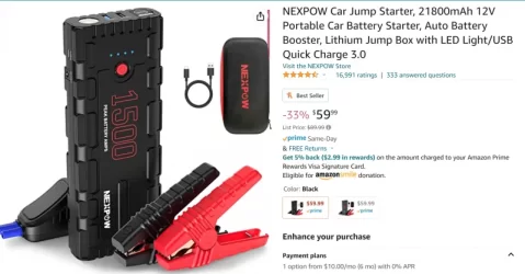

I think something like this would suffice. Just stick under the trunk in the rear for worst case scenarios. I personally hate carrying extra weight in my Niro, but the peace of mind you get from having one of these is worth it, IMO.

12 volt batteries are the most common point of failure in EVs and ICE vehicles as well...other than the nut behind the wheel, of course. Tesla has had a 12 volt problem as well. Don't discount the possibility that the battery is bad. Honda replaced a 12 volt on a Ridgeline I owned after it became clear that it just wouldn't hold a charge. I have a charger that I keep connected to USB. I did have a dead 12 volt in my 2019 Niro EV once. Figured that was because I just wasn't going anywhere (a little thing called Covid, you might recall) and the car was just sitting around. What I carry:

Yes, the 12V portable jump starter is a good idea. I carry one in both my cars.
